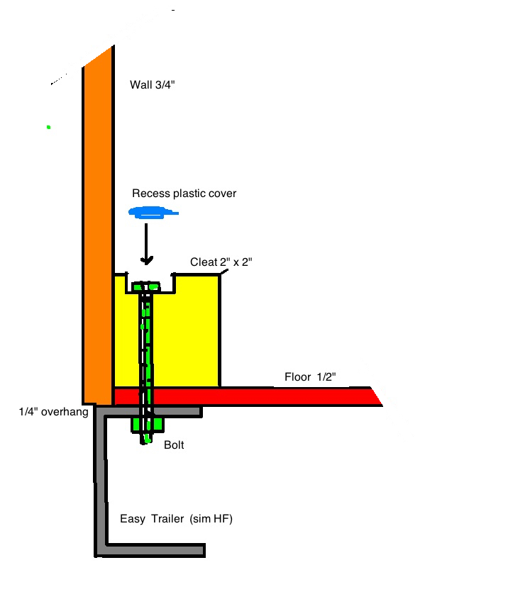

Postby Bil D » Tue Apr 19, 2016 8:05 am
Thanks everyone for your tips and ideas.Great forum
This my first build
Question.
Do you see any problem with attaching floor and cleat as per pic?
My reasoning is, I can check bolts from time to time and tighten ,also can remove from trailer as the need arises
cheers for now
Bill

Postby KCStudly » Tue Apr 19, 2016 7:50 pm
Looks okay to me. :thumbsup:

Postby Bil D » Wed Apr 20, 2016 12:19 pm
Thanks KC
I havn't seen another method like this on the forum (exposed bolts )
So thought I'd ask the forum
Better get on with it now.
Cheers Bill

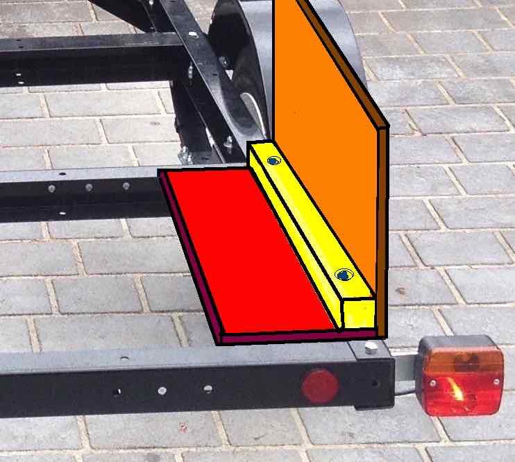

Trailer is an Easy Trailer (Aus ) )similar to your HF

Postby dales133 » Wed Apr 20, 2016 2:43 pm
Looks good to me to.
The other way you could do it though is fit T nuts in the floor and bolt into them from underneath then you can put a perminant floor covering over them,both methods will work just dandy though

Postby KennethW » Wed Apr 20, 2016 2:53 pm
dales133 wrote:Looks good to me to.
I did the t nuts with a sheet of insulation under the floor. and a 1x4 cleat glued and screwed from the bottom up to mount the wall on.

Postby dales133 » Wed Apr 20, 2016 2:59 pm
Ive used T nuts on mine to.
Recessed into the frame and the plywood internal flooring and comercial grade linoleum over that.
I dont intend to take mine off the frame at any point but it makes assembly a one man job

Postby lfhoward » Wed Apr 20, 2016 4:51 pm
Bolting it to the frame has worked well for me. I used washers on both the top and bottom, as well as nylon lock nuts underneath so they don't rattle loose.

Postby Bil D » Thu Apr 21, 2016 9:24 am
Thanks again folks for your help ,very appreciated.
Things can change I know... but the plan now is ,,,,,,
Walls sit on trailer frame ,overhang 1/4 " (room for bolts)
Cleats above floor bolted as per suggestions

Postby lfhoward » Thu Apr 21, 2016 12:20 pm
Sounds good to me! It sounds like you'll have everything you need, and other options can be added later. The KISS (keep it simple) principle will make it more affordable too. You'll be out enjoying your camper sooner.
