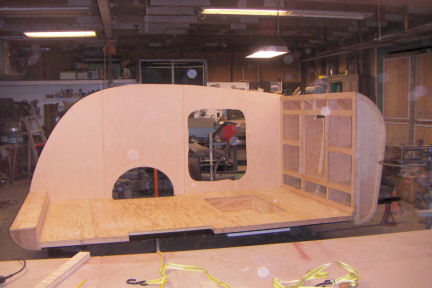

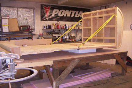

Postby Gaston » Sun Jan 29, 2006 6:19 pm
the tear I'm building has a 7" radius lower rear and 8"radius lower front. These are built as a subasembly of wood frames, ribs and 1/8 luan skins (to be covered with fiberglass) then attached to the ends of the floor & overhanging the frame rails. If you want a smaler radius you could start with a solid "chunk" like a 4x4 and plane away the excess to get the profile you want and attach it to the ends of the frame. Kind of like a bumper. I found a 7" radius was about the tightest I could get with 1/8" luan, but you could cover the ribs with alumium skins if you want a smaller radius nstead. I made the front radius as acompartment in a front cabinet to use the space . the rear radius will have an axcess in the galley and will hold the power cord. the down side of the rear radius is a high galley sill, making a stepped floor in the galley. Look at my album for more photos of them Image

Ok :) now Gaston's pictures came thru and I can see how you did them . Now ,is this the back section if so how about the front?

Postby Gaston » Thu Feb 02, 2006 1:08 am
the front of mine is built as a cabinet and forms the front of the trailer. built much like the rear. these pics show it best.
