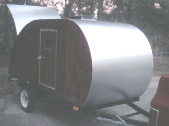

Postby Hardin Valley Magic » Sat Feb 11, 2006 8:56 pm
Julie here is the final product. sorry no pics of it before primer and paint. Sorry.

Postby Jimbo » Mon Feb 13, 2006 6:42 pm
Hardin Valley Magic wrote:Julie here is the final product. sorry no pics of it before primer and paint. Sorry.
Did I read right that your roof is painted? It looks like a sheet of aluminum. Dang good job!!!
Started many, finished none... Bought a TTT <Sigh> ;)
Jimbo
2nd Teardrop Club
Posts: 290
Joined: Sun Apr 18, 2004 5:56 pm
Location: Kentucky
Postby Hardin Valley Magic » Mon Feb 13, 2006 7:26 pm
Yup, it sure is barn and fence paint from Lowe's alum in color. 8) 8)
