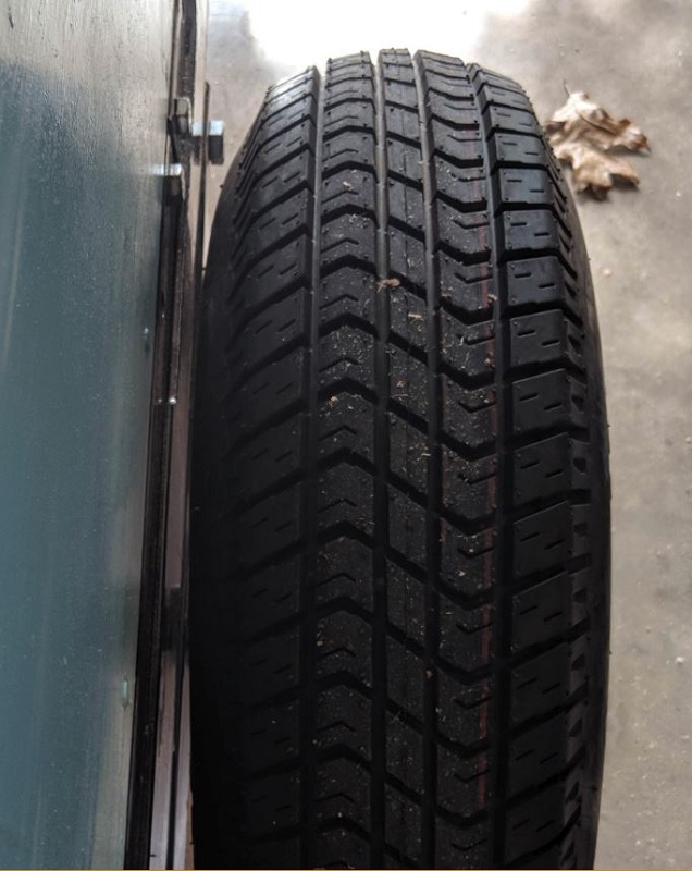

We got the 13" Martin tires installed at NTB
We have maybe just over a half inch of clearance between the tire and the frame at the closest spot. That makes me a bit uncomfortable but the tech said as long as we make sure the pressure is good we shouldn't have an issue. Should we be fine or get some wheel spacers? We have maybe a three quarter inch of tread left on the lugs.

dsotto wrote:We got the 13" Martin tires installed at NTB
dsotto's tire clearance.JPG (130.92 KiB) Viewed 7913 times
  • If you can keep your tires inflated to the max.cold pressure, have your lug nuts tight, and take no turns too tightly (or traverse roads that may become steeply banked), then you may be able to get away with such tight sidewall clearance. You did get the stiff-sidewalled ST tires, didn't you? That will help prevent contact. Also, it'll help if your trailer suspension is a bit on the harsh side, not soft, because that will help too.
  • Since my driving style is rather brisk, and often hard on suspensions, I always needed stiff suspensions, fully inflated tires (drag slicks not included), and sufficient tire clearance. Once, I blew an oversized rear tire on my Chevelle (when it was still street-able) that crumpled the rear fender, at 70+ mph. There was insufficient clearance inside the rear wheel-well, which is comparable to a trailer fender, showing (to me) that clearance is very important, on all wheeled vehicles. Following that, I paid more attention to tire clearance on all my stuff, thereafter.
  • There has been much discussion about how much clearance is needed for trailer tires, mostly concerned with the tire-bulge to trailer wall area, but some about the distance between tire top to fender . Actually, both areas are critical: if the tire rises up into the fender over bumps, then the tire tread will be abraded, and the fender may be pushed up, damaging it...and if the tire sidewall abrades against the trailer frame or wall material, then the tire may get cut (usually from a nut/bolt making contact),or the wall gets partially ground away, over time. Of the two scenarios, a cut tire sidewall is the most dangerous (tire treads are seldom severely damaged by incidental contact with the underside of a fender, unless there was no clearance there to start with).
  • Looking at the photo of your present tire clearance, I see possible bolt-head contact in your future...and from the earlier photo of your old tire under the fender, possibly some contact there, too, but possibly negligible. Like I stated, the tire must be kept from contact wherever possible. I think the easiest, cheapest, fastest recourse would be to get wheel spacers, of 1"-1.25" minimum thickness (I think your new tires will still fit mostly under your present fenders, but you'll have to measure). I've used many before....

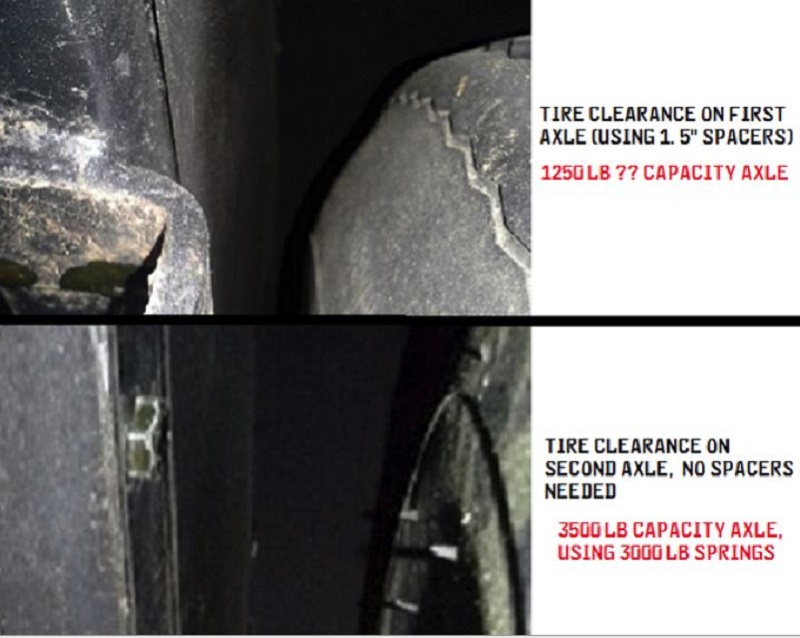

from an earlier thread
working on it wrote:
  • I've gone from having about 1.5-1.75" clearance, to about 3", and back down to 2+"...and my suspension has built-in safeguards to stop contact; in your case, why not get the extra width, just to be sure, as long as the outside width of your tires doesn't become a problem?
  • A leaf-spring axle, whether located front or rear on a car or truck (called a solid-axle on 4wd's & heavy trucks), or on a trailer, will cause one wheel to pivot up closer to the frame (or conversely, the fender lip on the other side), creating a fitment issue. If that see-saw effect isn't limited via a positive stop, or super-firm springs. then some tire scrub against frame or fender can be expected, especially on very uneven roads or trails. Independently-sprung tires (on IFS front suspensions on cars/trucks, torsion and Timbren-type suspensions on trailers), do not have the same problem. And, tire size, type, and section width also can increase the need for proper fitment, to avoid tire contact.
  • Tire sidewalls flex under load, sometimes moving toward a contact point, so the elimination of such contact requires spacing your tire so that the sidewall bulge (at the section width measurement point) doesn't come close enough. On the frame side, under most conditions, a properly-inflated tire doesn't need more than .75-1", but on fire-roads or trails, that requires more spacing, depending on: tire characteristics, proper or under-inflation, axle travel, and bumpstop or axle limiters that can prevent contact. On the fender side (low-riders need not apply), the taller/wider (more open) types of fenders on most trailers and trail-following tow vehicles, are already mostly safe from tire contact.
  • My original axle was noticeably inferior to what I wanted/needed to make my TTT able to traverse even mildly-challenging roads; I didn't have the budget at that time, for my axle of choice, so I just added wheel spacers to fit wider/taller tires under my selected fenders (good for 14-16" tires, as advertised), at least for the interim. I went from 8" to 14" tires, so it was a necessity to install the fenders/spacers, ASAP. When I finally upgraded the suspension, I got a wider axle (a requirement to fit in brakes), which eliminated the need for spacers, and also gave me more clearance between tires and frame, and the fenders still had sufficient clearance. too. The tire-frame clearance more than doubled, and that was a great boon, because I later added taller/wider/more flexible LT tires, in place of the rigid-sidewall ST bias tires I had used previously. I still retained about 2" clearance, but I did have to add fender flares to cover the outside tread, though no clearance issue with the fender was caused by the bigger tire. So, I have quite adequate clearance, all around.
    tire distance from trailer.JPG (114.25 KiB) Viewed 7913 times
Thanks for your response! It's been helpful. I've been doing more looking around on here and the only reason we went to 13" was that it was significantly better for driving. I'm seeing tons of people saying they've gone on 12" no problem.
The stock tires were 12" and 4.8" wide. At highway speeds we had zero sway (pull with Jeep compass and TD is 840lbs) so no problems other than what we perceived would be over use during long road trips. The new 13" tires are 6.5" wide and the high speed 12" tires are 5.6" wide. I read up on wheel spacers and they seem like more trouble than what it's worth. I think we might return those 13" and get the high speed 12". That way would would be right at 1 1/2" clearance between frame and tire. We planned on scrapping that stock fender (which are installed per directions and we thought they looked low too!) and getting some pretty smooth black ones anyways. We just had them for protection with our first couple trips until we did this wheel change out.
I'm glad you mentioned all the things you'd done because it gives more options if/when we want to take the time to make a big change. I love the idea of bigger tires for aesthetics as well but not for the struggle it's presenting.
