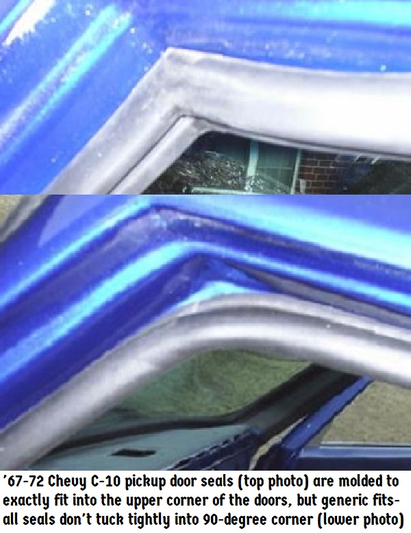

* Another thing about using those leftover seals from my truck restoration: they were really too thick to let the doors compress them and still remain flush with the sides, so I used scissors and cut about 1/4" width strips from the bulbs, nearest to the inner doorjamb, so they would still have plenty of rubber there, and fully compress. I nearly bought different ones, but the molded corners of the "factory-style" '67-72 Chevy C-10 door seals fit so nicely into the corners, that a little work on them was worth the effort.
comparison photo showing the tighter fit using the (top) seals (shown on a C-!0 pickup (not mine)
door seal, tight corner for exact fit.jpg (151.76 KiB) Viewed 6425 times

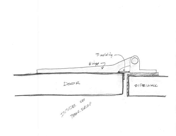

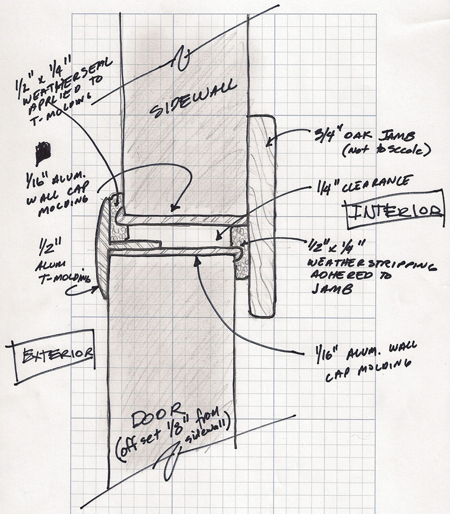

I built my doors similar to how you propose to build yours. Initially, per the sketch below, I was planning on using an outer seal on the t-molding and an inner seal on the door jamb.
However, the seal on the t-molding worked so well that I never got around to installing the inner seal (or the rain gutter above the door.)
The seal I used on the t-molding was a "D" type seal. As the previous posters stated, you need to leave room for the seal. Generally, the seal should only compress about 1/3 of the seal height. To allow for the seal thickness, I used 1/8" thick nylon spacers to offset the plane of the door from the plane of the sidewall. This 1/8" "gap" allowed for the D seal to compress appropriately.
Lastly, if you plan to use t-molding on the hinge side of the door, you need to make sure that the pivot point of your hinge is outside or beyond the outer edge of the t-molding. Otherwise, the t-molding will bind on the door when you try to open it.

aggie79 wrote:I built my doors similar to how you propose to build yours. Initially, per the sketch below, I was planning on using an outer seal on the t-molding and an inner seal on the door jamb.
