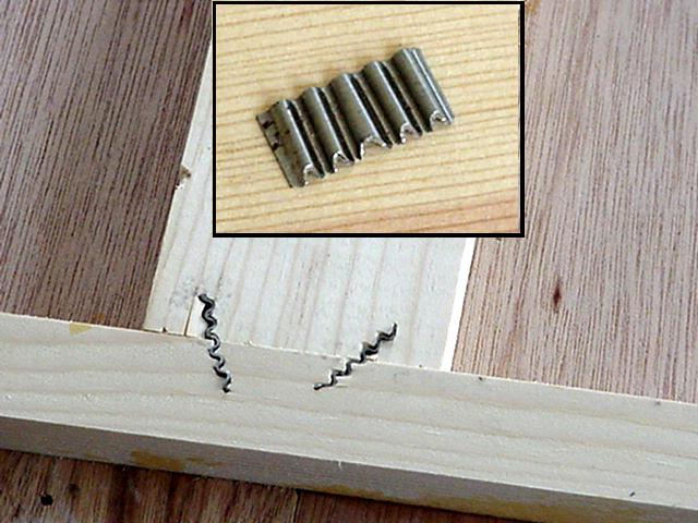

I don't remember what these connectors are called, but I think they were intended to mend wood framing on screen doors. I probably bought these over 20 years ago and they have just been sitting around in a jar waiting to be needed...and now, they're so happy that they are needed and finally being used!!!
I discovered them in my workshop stuff, and am using them to fasten framing pieces together as I construct my sides. They work great in pine or spruce (soft woods), but I doubt they would go into oak so easily. You just hammer one or two connectors into the wood to fasten them together. As you can see from the inset close up, they are wavy so they won't pull out easily. The're working fine for me.

They are corrugated fasteners. They use to be associated with the construction of orange crates but cardboard boxes are used now. Not the type of fastener I would recommend.

Dear Dale,
Corrugatoed fasteners were designed for crates and frames to be used on mitered edges and not as you are using them, especially since you are using them in opposigte directions and creating a narrow break which can pull out the whole trapezoid created by the angles. T way you could use themis to reverse the angles so that the trapezoid is larger on the bottom of your photo than on the top and extending out past your vertical frame.

I was going to really let Dale "have it" until I realized he wasn't connecting anything of structure! All he is doing is connecting the framework for inside his walls..............and all of that will be glued to the plywood on both sides (I'm assuming), so no matter how he connects them, they should be alright. Now it would be an entirely different matter if he were using those to make a faceframe for the cabinets.

Thanks, Chris...you got the picture. No structural strength is required where I'm using these fasteners. They really hold the pieces together while the glue dries. I have glued and clamped or weighted all of the framing to the outside skin, and when I can get the side upright, I'll add some 3/4" screws from the outside through the skin into key framing pieces for insurance (i.e. sheet joints and a couple of horizontal pieces front to back). The windows and door will have screws through the skin into framing as well.

Those things are a great idea! Most of the areas where they would be used are covered in plywood resulting in a huge corner gusset which will be really strong. Way faster and easier than a pocket hole for the proper application. I used staples to hold the 1 X's but they present their own problems (not countersunk, only holding 1 side, etc.). If I had thought of these, one at each joint would have worked perfectly. Maybe I can use some for the door framing and the bunk frame. Thanks for the tip!

Dale,
An excellent application of a simple product. My compliments to you.
