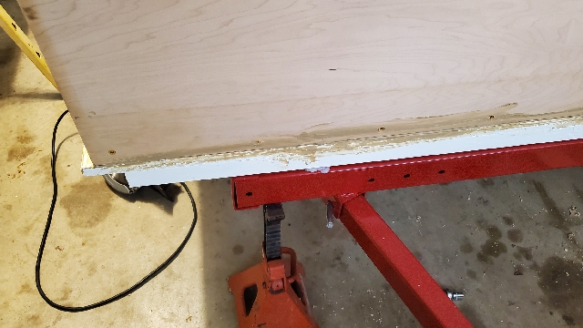

Hello,
I used a simple lap joint (wall on floor w/cleat) to attach my walls. It is a ways down the road but I am starting to consider how I will trim that out. I'm thinking corner tape and butyl but want a wide trim around the bottom. Maybe 4-6 inches wide. Any thoughts or ideas for this trim? Here is a sample of where it will go.
This is along the front so you can see a support member, then the floor and finally the wall on top. Down the sides it's just the floor, wall and screws. The goal is to seal the layers, the screws and cover the frame. Final coatings will be applied before any trim goes on. Most likely a great primer and Line-X or similar.
Thanks in advance!
philpom

You could put a strip of aluminum diamond plate along there.

4" x 3/32" (or 1/8") with screws & Sikaflex will work. You just need to make sure the pieces fit will prior to trying to attach them the trailer. Make them first & cut around frame members & other things for a nice finish. Use the front one to cap the side pieces, use the side pieces to cap the rear piece & you're set. Sikaflex & stainless steel screws (with pilot holes drilled first in the trim) will get the job done, look good & last as long as you need it to.

Thank you. I assume when you say "use the front to cap the sides" you mean to create a 1/4" 90° bend at the ends that will wrap the corner and cover the seam. I do not have access to a break to make those bends. Any tricks to get that done?

No need to bend them, just put the back on first, then the sides & finally use the front to cover the edges of the sides. That should be enough to hold things in place. If they hang down below things, you can fasten angles behind each of the corners for a better joint & fit. It will reinforce the corner & take fasteners.
