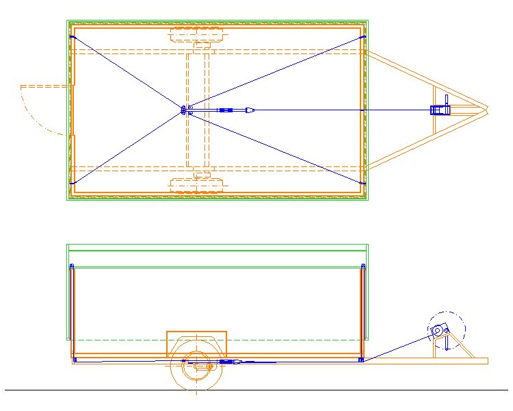

Lifts:
Coleman:
Andrew Gibbens lift design (modified for XPStream by OP827):
http://tnttt.com/viewtopic.php?p=38750#p38750
