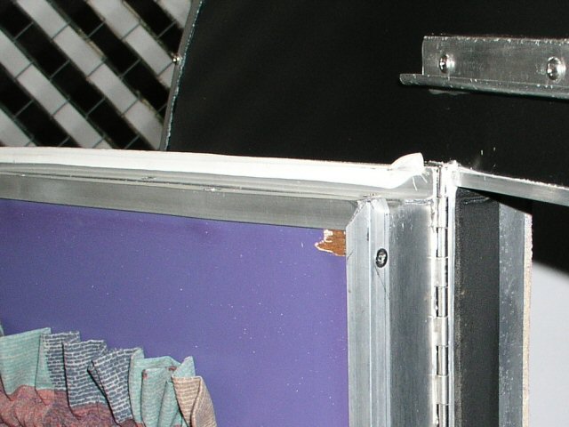

Postby sunny16 » Tue Feb 28, 2006 10:37 am
This is a picture of the door gasket I want to use.
Gasket profile:
The square side fits a 1 inch thick door and the gasket side offers about an inch of cover and about a half inch of gap. Half of this is a hard plastic and the gasket side soft rubber. WOrks real well except for the mitering of the corners. But it should give a good water tight fit.

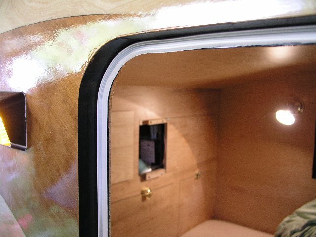

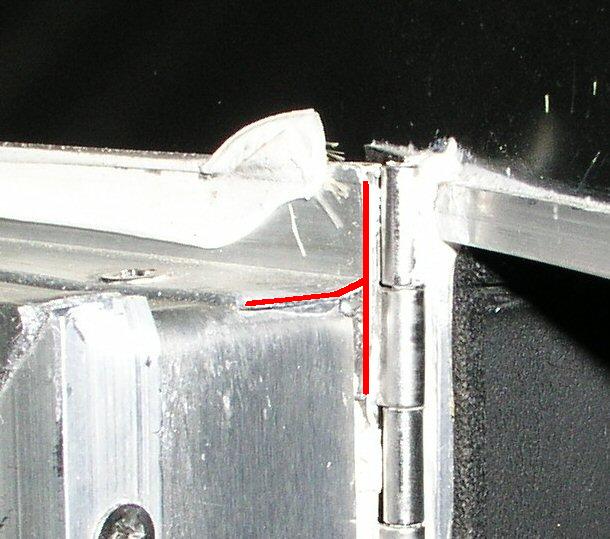

Postby sunny16 » Tue Feb 28, 2006 10:38 am
One more picture. I haven't figured out how to post multiple pics yet.

Postby mikeschn » Tue Feb 28, 2006 11:15 am
Oh, I think I understand the question now. You have a gap between your walls and your door, and you want to seal out the elements.
You can either use an interior sealing plate... Like on the Lil Diner... let me see if I can find a pic...
Or t-molding. Again, I'll look for a pic...
Postby mikeschn » Tue Feb 28, 2006 11:28 am
Okay, here's the tmolding...
Postby mikeschn » Tue Feb 28, 2006 11:34 am
And the Lil Diner door seal..

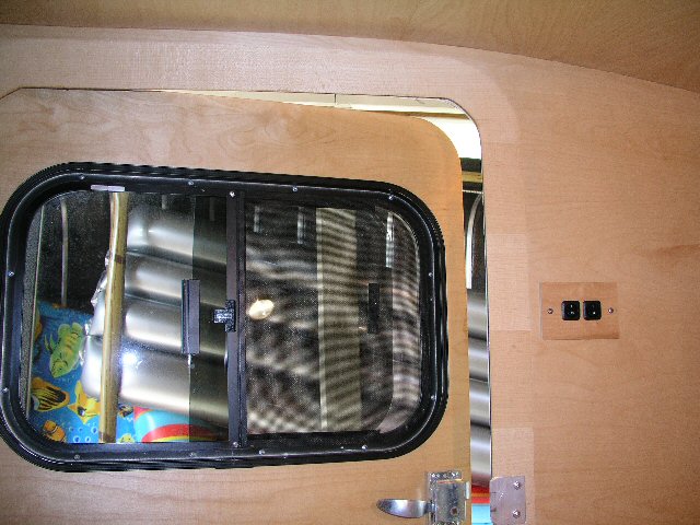

Postby Loader » Wed Mar 01, 2006 10:28 am
Mike,
Looking at the two methods you used to seal the doors, which one do you prefer, and does one work better than the other? I am leaning towards the Diner method, I think the look of the extra trim/frame on the inside could be a nice accent. Looks a little easier to construct as well.
Thanks
Earl & Kerry
"Loader"
Loader
Posts: 1584
Images: 245
Location: Fort Worth, Texas
Postby mikeschn » Wed Mar 01, 2006 11:47 am
Earl,
Both ways work good. I think a lot of it depends on the shape of the doors.
Rectangular doors, and doors with only 1 large radius like on the benroy work well with the t-molding. Doors with small radii on each corner work better with the inside style seal.
Also, the image you are trying to capture plays a part...
Postby Loader » Wed Mar 01, 2006 12:52 pm
Thanks Mike! I think I'll be using the inside seal for my doors.
