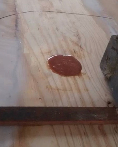

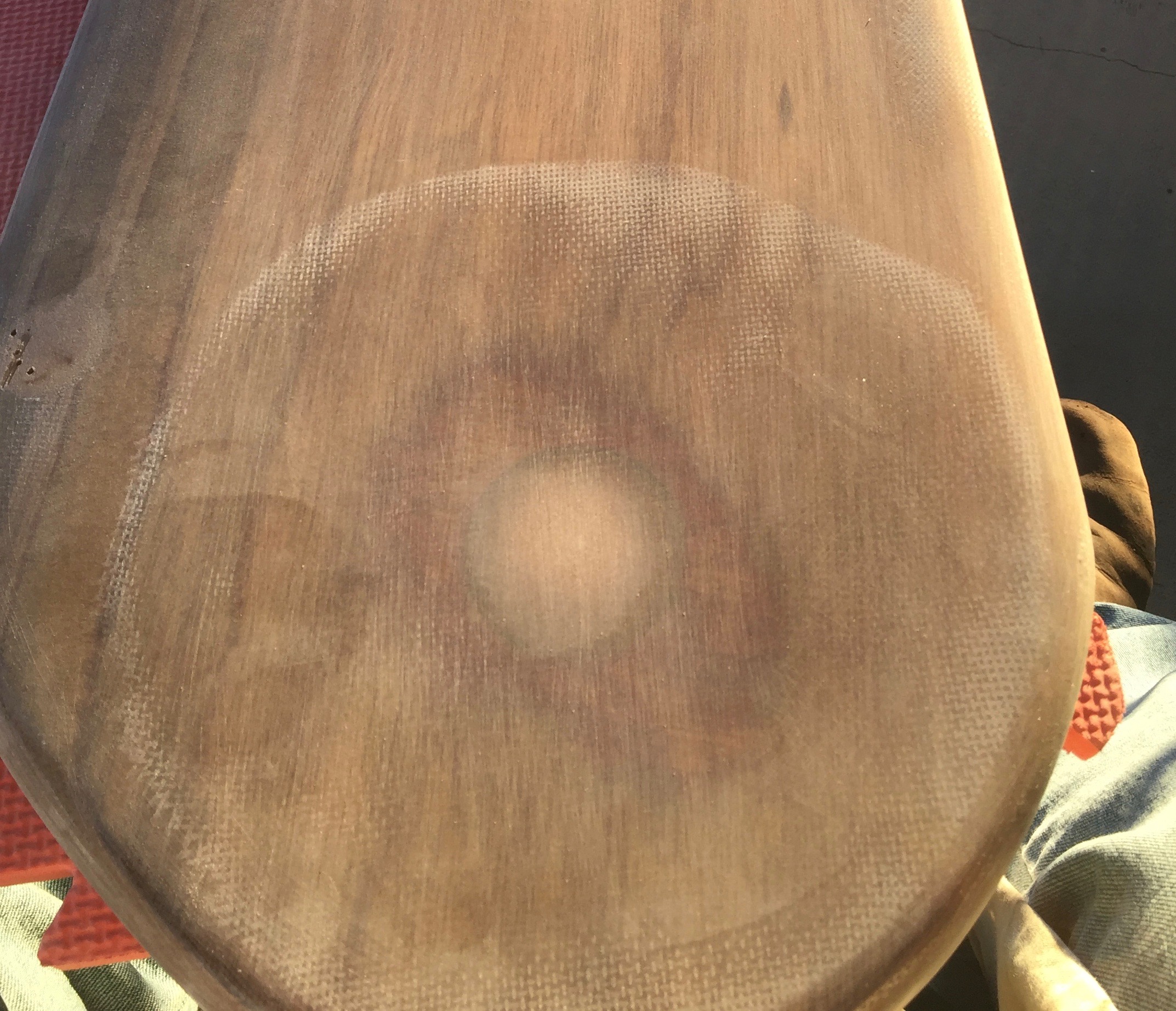

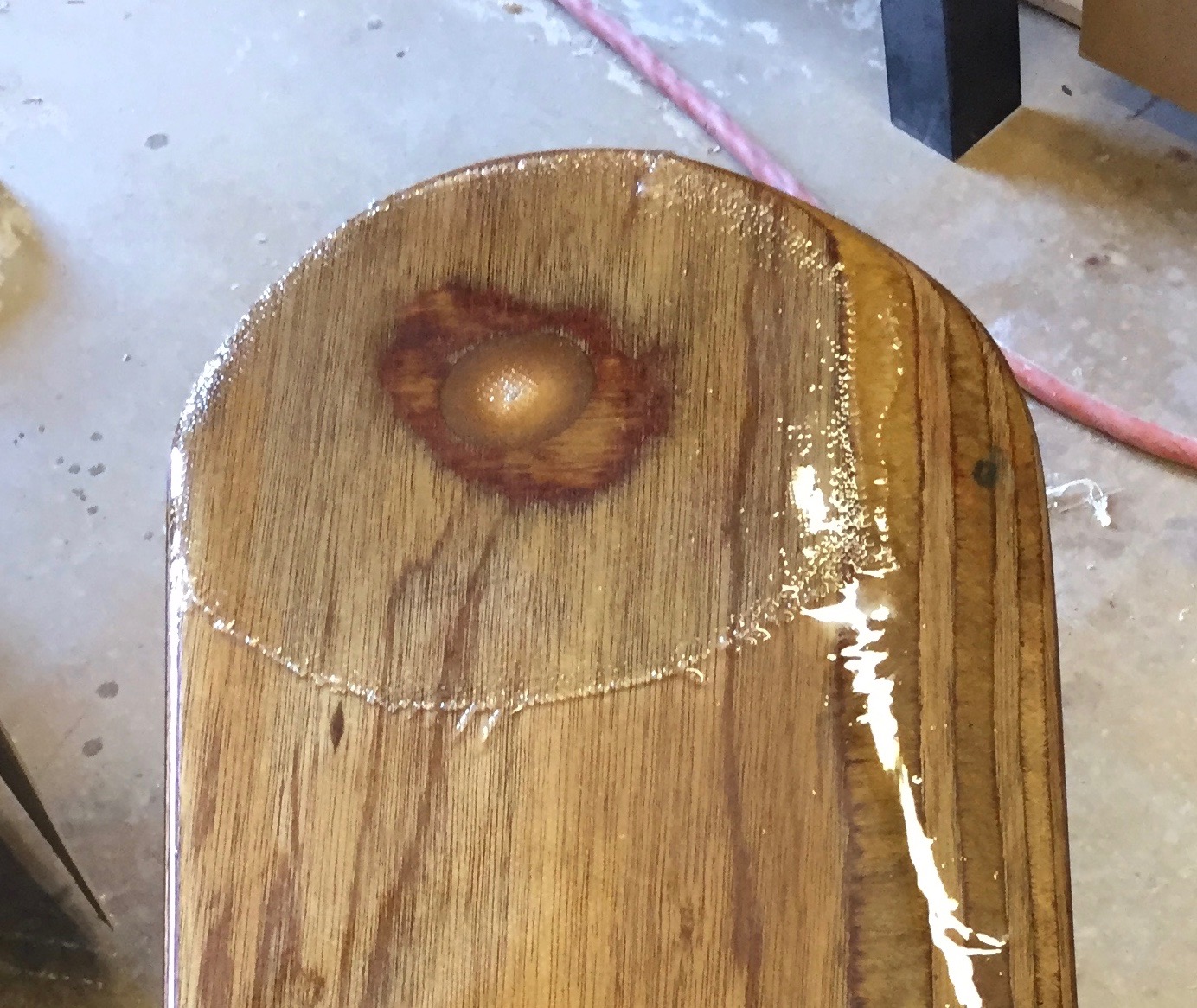

any time i have need for a pivot point or location where a fastener is likely to be removed n replaced in wood i drill an oversized hole and plug it w/ thickened epoxy
in thicker panels small stainless fasteners(nails) are inserted into the edges of the holes to hold the pox in place
in panels that are thinner the epoxified holes are sheathed w/ 6oz cloth which gets faired and finished
the ultimate hole needed can then be drilled thru the epoxy w/o fear of water intrusion into the inner edges of the panel
just an option

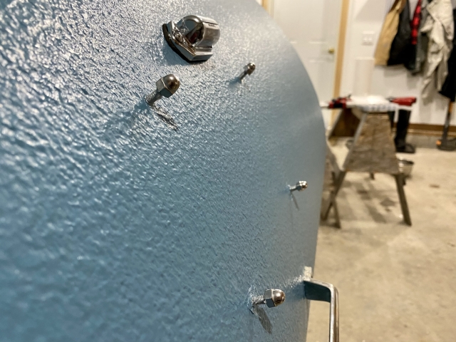

Postby GarthB » Tue Aug 24, 2021 9:56 pm
Figured I'd post a follow up in regards to which route I ended up choosing. Not sure if anyone has tried this option before, but I decided to go with hanger screws. They have wood threads on one end and machine screw threads on the other. I screwed four of them into the hatch so that I could use a nylon lock nut or a cap nut, like I have shown, to hold the license plate and bracket down. I like the cap nuts because they should protect the 10-24 threads well over the years.
I predrilled each of the holes and made sure to use a healthy amount of polyurethane sealant in and around each hole.
Thanks again for all of the help and feedback everybody.
