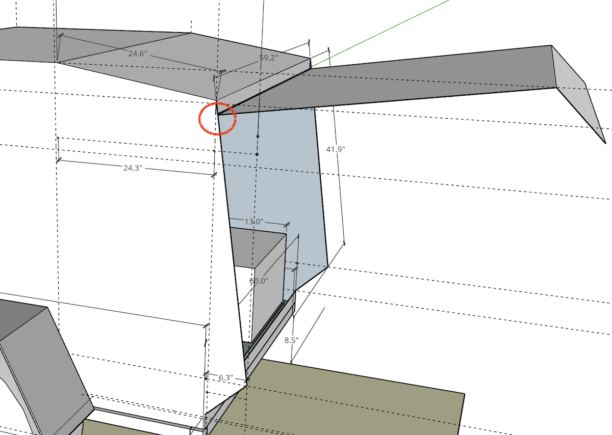

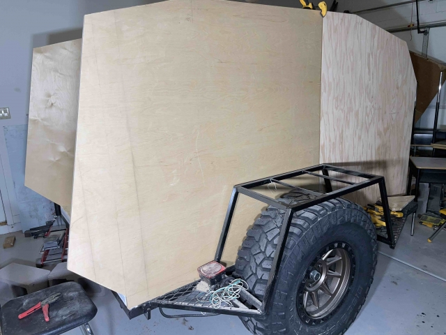

I think I have cornered myself by cutting the side walls first, then work on the hatch design :(
I got feedback my hatch design is prone to water leak, and bending the aluminum will also be a serious challenge with the angles. As much as I hate it, I may consider redoing the design if it's not workable. But I have to do that before I screw and glue the walls. I have put my build on hold. Any feedback is greatly appreciated. I would like to know if my design is workable or salvageable.
I bought a hurricane hinge with 1/4" offset and 040 aluminum sheets. I see a possible way to add the hatch (shown in the drawing): bend the roof edge 2" on the back, place the hinge at the red circle position (about 5'8" or 68" from the ground). I want to make sure two things: 1) the design is not inherently flawed that will lead to water leak 2) the gate can be lifted high enough, a 5'8" or 5'9" guy can stand under the open lid.
Since I don't have a curved back, can I even use a hurricane hinge like shown? Any other way to place the hinge?
If the design is flawed, any way to reshape the already cut plywood? e.g. rounding off the corners.
I'm already considering rounding off the top roof corner above the hinge, and also the big angle on the lower part of the hatch. But I don't know if that fundamentally changes anything.

As drawn, that design doesn't look particularly flawed to me. Assuming you put the correct half of the hinge on the upper side, let it protrude a half inch to an inch past the side walls, seal it properly where it screws down, I can't see it being any more flawed than any other design.
I had an issue with water getting under my hinge. $5 worth of Sikaflex 252 properly applied fixed it.
viewtopic.php?f=50&t=71977&start=261
A suggestion that may or may not improve your sleep:
If you have not yet cut that 24.6 x 59.2 roof panel, consider making it 25.6 x 59.2. An inch of overhang on a slight downward slope would direct a lot of run-off away from your hinge.

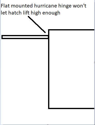

So, I was up at 'ol mate Reg's place helping him turn over his trailer chassis.
Mission accomplished the conversation turned to TD building in general.
We were looking at his first build, a square drop. The galley hatch is a flat panel on the back wall.
He used 4 butt hinges for that hatch. He showed me how the hurricane hinge he bought for the next build will not open far enough.
It only opens a touch past 90 degrees, and that isn't enough!
I never thought of that.

Postby tony.latham » Mon Feb 07, 2022 11:00 am
It only opens a touch past 90 degrees...
Good catch, Mick. I was wondering how well they would seal when installed vertically. :thumbsup:

Postby MickinOz » Mon Feb 07, 2022 6:19 pm
Reg's 1st trailer is a full on squareback. So the hatch when closed is exactly perpendicular to mother earth.
The hinge he has for the second build I estimated at maybe 100 degrees fully open. It might be the same 110 degrees you measured, I was just guessing. In any case, his hatch would be 10 or 20 degrees degrees above horizontal at maximum opening. Not enough to provide the headroom he wants if he uses the same squareback design he used for the 1st trailer.

Postby MickinOz » Mon Feb 07, 2022 6:24 pm
I reckon they'd be no different than when laid on the curve or flat on the roof, except for one thing.
With a square back, the hatch is flat, not curved. If opened above horizontal, it's not like a curved hatch where some still runs off the back. All rain water runs toward the hinge, and in a decent downpour this might overwhelm the hinge's ability to channel it out the sides, some might overflow through the hinge mechanism.
Even so I think it'd have to be fairly heavy rain, you'd probably be inside with the hatches closed.
