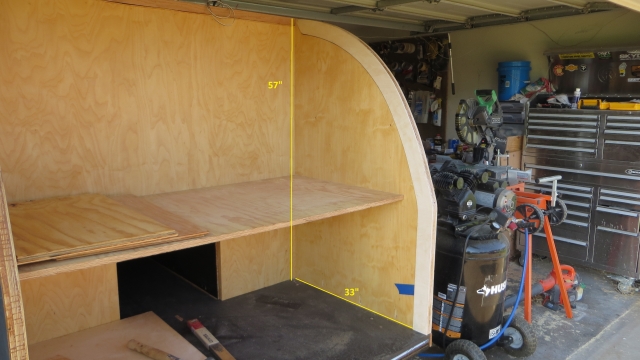

I will be making my hatch shortly. My intention has always been to use Steve Frederick's hatch seal system.
Looking at my galley/hatch it looks like I will have to put my 1/8" spacer and 1/2" seal plywood in the area outlined in red (see pic below). That seems like a lot of extra weight seeing how my Galley bulkhead is 57" and the counter top plus a few inches is 33"
Am I correct in thinking that is where those should go?
Any thoughts/suggestions or alternatives?

Can someone provide some feedback that has experience with this type of hatch?
Do I need to make a cut out for the entire galley side wall?

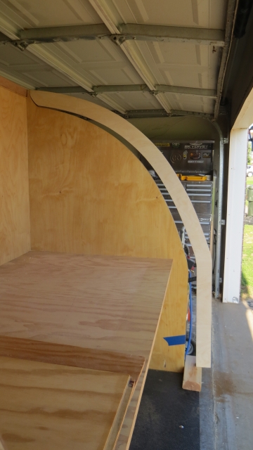

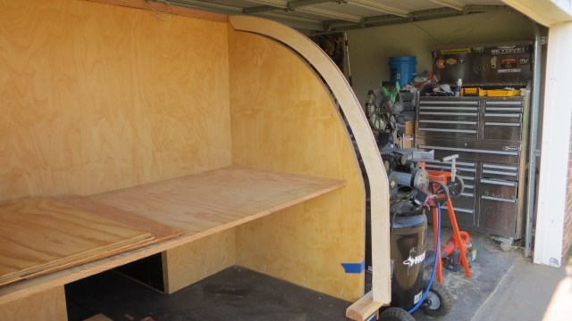

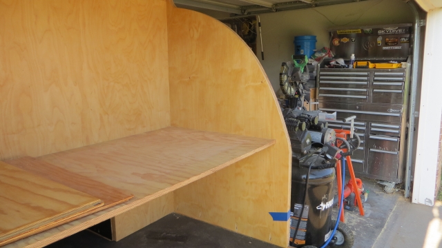

Postby tony.latham » Thu Aug 24, 2017 10:46 am
Wayne:
I've done it both ways, and you're right, Steve's suggested method is weighty. I did it the lighter way in this little 4x8 I built for my sis.
I hope this is the answer to your question.
p.s. Make sure you've got plenty of room with your counter for the hatch's gussets.

Tony, I had the exact same thought on how you did it. I wasn't sure if that would work but looks like you got it.
My concern with that was I was going to use my sidewall as a mounting surface for a slide out drawer. I am eventually going to mount a ARB freezer there and don't have a lot of clearance. I thought the drawer might hit the lip that creates. I can measure the clearance on the drawer slide maybe it will be greater than the 5/8" lip for the hatch seal.
I noticed in one of your pics there is a cooler down there. Did you put it on a slide?
Also do you have a finished picture of the galley?
Thanks for the help!

Postby tony.latham » Thu Aug 24, 2017 12:13 pm
[img]My%20concern%20with%20that%20was%20I%20was%20going%20to%20use%20my%20sidewall%20as%20a%20mounting%20surface%20for%20a%20slide%20out%20drawer.[/img]
There you go, thinking this stuff out. :thumbsup:
As you can see in this picture, I had to add blocking for the drawer slides.

Postby Esteban » Thu Aug 24, 2017 1:47 pm
Tony, it looks like you have improved the Steve Fredericks' galley hatch design in several ways. Bravo!
1) :thumbsup: The most obvious is that you reduced weight by using an inner curved ( 1/2" ?) plywood (male) lip instead of fully covering the inside sidewalls of the galley with 1/2" plywood. It may cost less too.
2) :thinking: It also looks like your outside hatch rib gradually widens in the middle more than it does at the top and bottom, which would help stiffen the galley hatch. Steve Fredericks' plans, instead, have a somewhat similar wider in the middle hatch stiffener on the inside of the galley hatch. This looks like another way your design reduces weight and construction complexity.
3) You also have multiple horizontal inner hatch ribs instead of multiple vertical (fiddly to make correctly) curved inner hatch ribs. To my eye this looks easier to build (less construction complexity) and it may be less prone to construction errors that sometimes lead to do overs. It may also cost less.
4) :thinking: I'd like to see a photo, or more detail, about how you weather strip the hatch. I'm unsure if your design creates an upper (female) socket for the weather strip like a Fredericks' design does. I'm guessing that your rubber weather strip will be used somewhat like an edge band at the interface of inside/lower hatch skin and outer ribs once you install the inside/lower skin to the galley hatch?

Postby tony.latham » Fri Aug 25, 2017 7:52 pm
Well.... I build my hatches according to Steve's plans. I swear. Iv'e done it three times. (Hopefully I haven't screwed them up. :frightened: )
The seal is exactly as Steve's manual suggests. And they are dust proof and spring-back-proof with that 3-4" (or is it 6"?) gusset. Don't quote me on those dimensions. (I'll never understand the hatches that have several vertical ribs, BTW. Way too much labor!)
Building that lip for the little 4 x 8 in the above pics, instead of a full piece of 1/2" ply does save some weight but it also adds labor (there's that damn word again). Everywhere a slider will go, you have to add 1/2" blocking...and since there's a 1/8" spacer piece behind "my" lip edge, there has to be one for each of the blocking pieces. So you don't loose all that much weight.
What I do highly suggest with Steve's methodology is a change in the walls from 3x4" pine to 3/4" plywood. I've done it both ways, but never again using boards. Too much labor. (There's that word again.)
