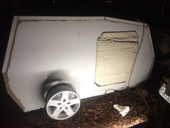

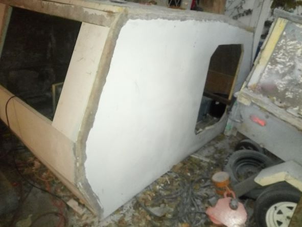

I did a foam/fiberglass on my truck (truck camper) and used a steel skeleton. Only reason for it is the overhang (loft) over the roof.
168576
Add elements as Pmullen recommends.

RJ Howell wrote:I did a foam/fiberglass on my truck (truck camper) and used a steel skeleton. Only reason for it is the overhang (loft) over the roof.
168576
Do you remember how many bars you used, vertically and horizontally, and how much extra weight it added?

Postby RJ Howell » Tue Mar 22, 2022 6:57 am
[/quote]
Do you remember how many bars you used, vertically and horizontally, and how much extra weight it added?[/quote]
168588
The build is here: https://www.tnttt.com/viewtopic.php?f=55&t=72408
Pictures come back on page 2...
The camper with frig, was 70lbs over the removed bed weight. I have the actual numbers somewhere...
