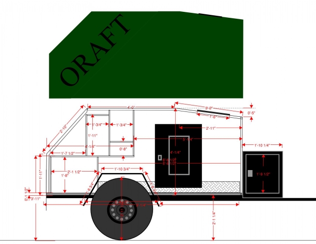

Postby Onajourney » Tue Jul 26, 2022 2:10 pm
I need advice on where to locate the HH. Should I go with how I drew it below or do I need to turn down the roof a bit then mount the HH. Does it even mattter? Image

Postby halfdome, Danny » Tue Jul 26, 2022 3:12 pm
It appears you have unequal angles, a 90 degree to a 45 degree.
If they were both equal like two 22 1/2 degrees you would have more mounting area and less chance of binding.
Get your hurricane hinge and do a mock up off your drawing to make sure it will work.
To me theirs not enough wood to mount it in that location.

Postby JasenC » Tue Jul 26, 2022 7:32 pm
The way you have it drawn doesn't leave a lot of meat for the hatch screws. One way is to change your hatch framing from a plumb cut to a level cut, thus in plain with the roof, extend roof framing with an angle cut so comes in under the hatch, you'll get plenty of meat.

Postby tony.latham » Tue Jul 26, 2022 10:00 pm
I'm wondering about your hatch framing?
It looks as if the hatch is about 1" or so thick?

Postby noseoil » Wed Jul 27, 2022 7:47 am
Typically, the hinge will work well on two surfaces which are nearly flat, or parallel to each other in alignment. Tony has raised a valid point about framing & JasenC as well, with the beveled edge for fastening being weaker & less meaty.
It might be easier to build with a more "conventional" approach to building the hatch. If you add a returned edge to the cabin part, it would make framing, fastening & sealing a bit better, stronger & easier. Just sayin'...

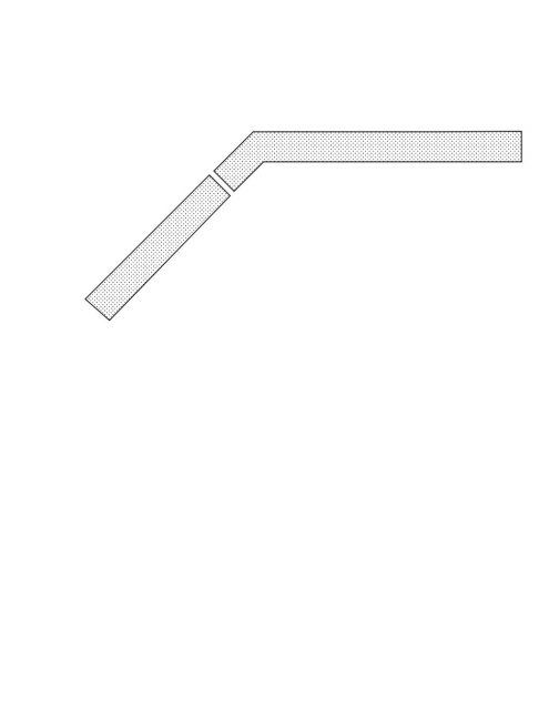

Postby Onajourney » Wed Jul 27, 2022 9:11 am
Is this what you guys are recommending? Seems like the way to go. I am planing framing roof and hatch 1.5". Walls and floor 1". I also plan to add steel reinforced brackets to the hatch frame angle. Thanks for the constructive feedback. I have been fiddling and refining this design for too long and need start getting sawdust on the floor. Image

Postby noseoil » Wed Jul 27, 2022 11:54 am
That looks easier to build, hinge & reinforce. You lose a small amount of height, but will gain in the ease of building & less leakage.

Postby JasenC » Wed Jul 27, 2022 12:02 pm
Onajourney wrote:Is this what you guys are recommending? Seems like the way to go. I am planing framing roof and hatch 1.5". Walls and floor 1". I also plan to add steel reinforced brackets to the hatch frame angle. Thanks for the constructive feedback. I have been fiddling and refining this design for too long and need start getting sawdust on the floor. Image
That's the ticket, that will be much stronger and accommodate the hinge much better.
You could also move that joint up onto the roof if you needed a bit more headroom, but then you have a little bit of a standing water scenario.

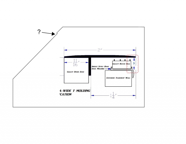

Postby Onajourney » Wed Jul 27, 2022 2:18 pm
Thanks fellas. I only want to cut the walls once. One last question...today. It appears I need to drop the wall a bit to accommodate the hatch seal to keep the external skin flush. Do you know that dimension? I am going to use the 4" T Molding trims from VT below which does not include that dimension on their site. Or should I get the trim and seal before cutting to verify? You would figure after all I have read on this site for months I would know these things.

Postby noseoil » Thu Jul 28, 2022 8:38 am
Usually better to have the parts on hand prior to making those decisions. With the parts, you can do a mock-up of the offset, location & trim. Without it, just a guess & it involves time, money & frustration if things don't go as planned...
