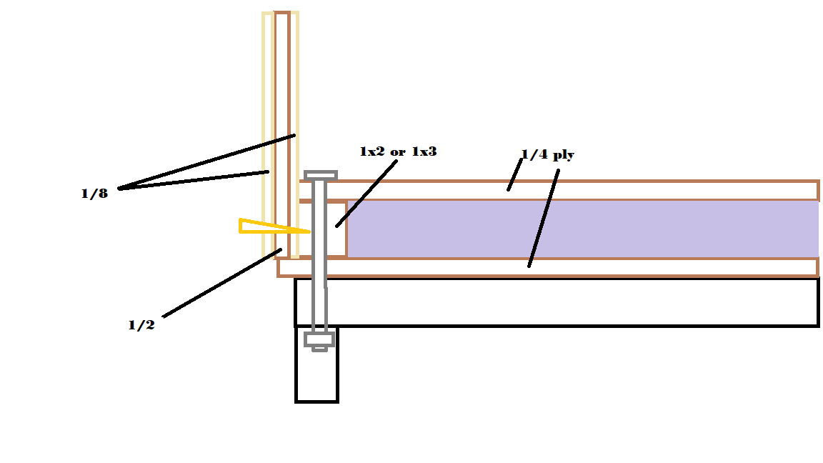

What do you guys think?
Postby 23Sojourney45 » Fri Aug 11, 2023 1:37 pm
Here is an idea of how I'm thinking of attaching my wall to the floor/frame. The floor is 1x2 frame sandwiched by 1/4 ply top and bottom. The wall is 1/2 ply sandwich by 1/8 ply inside and outside. The 1/2 ply will be cut creating voids for insulation/wiring. As you can see, the bottom 1/4 of the floor ply has a lip, sticks out about 1/2 on purpose so the wall can rest on it. The walls will then be screwed from the outside into the floor frame, gold arrow. The lip is about 1/2 inch wide because of the carriage bolt, if the bolt holes were further in (they can't, I don't have tabs) then I would have more room for the whole wall to rest on. I would move the 1x2 floor framing in some more but I can only go so far before the carriage bolt has nothing to grab onto. The integrity of the wood will ot hold the closer I drill to the side edge of the 1x2. Now, the wall, when assembled, will measure 3/4 inch thick, BUT only a portion of that will actually rest on that lip and the rest will just hang out. I already bought the wood, so they can't be returned. Any thoughts? :thinking:
This will be a light build, I'm not putting anything heavy on the roof like a RTT. I'm also counting on the galley wall, headboard, front roof spars to take the load as well.

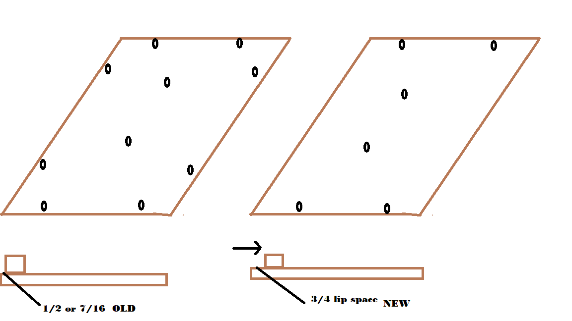

Postby 23Sojourney45 » Fri Aug 11, 2023 1:43 pm
I could do this: Here's a picture of where my bolts were going to be, the left side is the OLD way. The 1x2 floor framing gives a 1/2 inch, more like 7/16th lip space for my wall WITH 2 carriage bolts bolting the 1x2 to the trailer frame (sandwich). 10 Bolts altogether.
(the two bolts in the middle field is going to the trailer frame crossmembers)
The right side, I moved the 1x2 floor frame inside giving me a 3/4 inch lip space. BUT, in doing so, there will be no carriage bolts on the long side of the trailer, on both sides. Would this work? or would I need bolts on the long end? 6 Bolts altogether.

Postby tony.latham » Fri Aug 11, 2023 1:54 pm
Any thoughts?
I think you need to cover the lower part of your floor framing with the wall. Seal the deal. And it'll look better.
Just take that exterior sheathing and extend it out another 1/4".
If you don't have the material, build your floor framing from 3/4" pine. 3/4" of foam board for insulation in the floor is fine.
(Those gussets are to hold the thing together until the other side is sheathed.)
You might consider bringing the trailer to a welding shop and having six tabs welded. I use 2" angle for that purpose. They won't charge you much.
Place them where you can get to them after the cabin is mounted. I drill 1/4" holes in them for pilot holes before the final 3/8" holes are drilled.

Postby 23Sojourney45 » Fri Aug 11, 2023 4:08 pm
tony.latham wrote:
Any thoughts?
I was thinking along your walls from your previous pictures Tony, if I extend the 1/8 outer layer down to cover the outside edge of the bottom ply, will it be enough to hold? providing I glue/screw like you did? I forget the thickness of your walls.

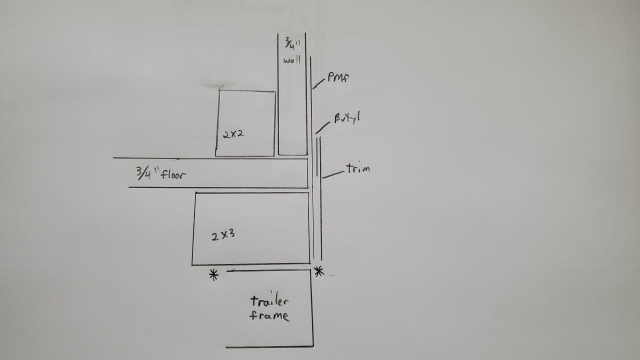

Postby philpom » Fri Aug 11, 2023 4:23 pm
I did mine as illustrated below (sorry, no fancy CAD for me). Seems strong to me and the pmf/dicor/butyl/roof patch have created a perfect seal in that area. Glued and screwed.
Side walls
Front and rear walls

Postby 23Sojourney45 » Fri Aug 11, 2023 4:38 pm
philpom wrote:I did mine as illustrated below (sorry, no fancy CAD for me). Seems strong to me and the pmf/dicor/butyl/roof patch have created a perfect seal in that area. Glued and screwed.
Side walls
Phil, I see that you have a bottom lip as well, its nice that you could fit your 3/4 inch wall perfectly onto it which is my concern as previously mentioned. Did you have any issues with your carriage bolt placements or however you bolted your wood frame to your trailer frame like me? I don't have tabs.
