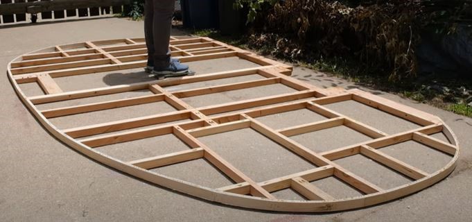

Option 1: Stick Frame
Like this:https://youtu.be/E6ndV1Kpx9k?si=vBkarDonxQWx11ee&t=1155
wall stickframe.JPG (62.64 KiB) Viewed 1041 times
PRO:
Easy to build out to the right thickness.
Easy to insulate
Easy to line up any seams for exterior skin
Can Build horizontal
CON:
Weight
Complexity
Difficult to get exact profile (curve) I am aiming for

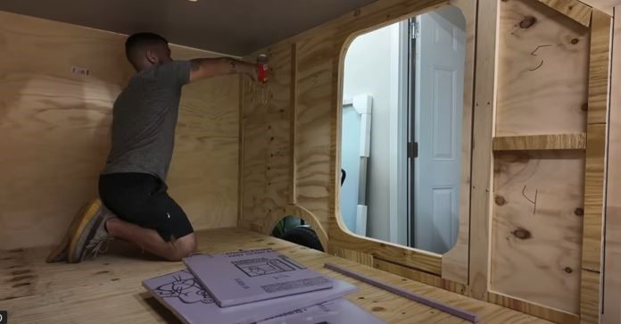

Option 2: Plywood laminated with Luann for the interior finish
Like this:https://youtu.be/psmUb8IL8VE?si=S3VKyU-tf1KVJ6b1&t=464
Option 2: Plywood Laminated
wall plywood.JPG (68.02 KiB) Viewed 1041 times
PRO:
Easy to get exact profile I am looking for.
Easy to cut in individual pieces then mount.
CON:
weight?
difficult/impossible to add insulation
Finished interiors before they can be properly protected.

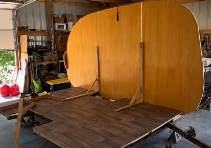

Option 3: Hybrid - Start with Plywood, the build out wall thickness for insulation and interior finish once exterior sheeting is hung.
Like This: https://youtu.be/I58YwgGhHtY?si=HNicmVRvuCqvef7V&t=508
Option 3: hybrid
walls hybrid.JPG (41.95 KiB) Viewed 1041 times
PRO:
Can tackle on my own.
Exact profile.
Easy to insulate.
CON:
Weight?
Have to hang interior walls after exterior walls are up. (harder to finish?)

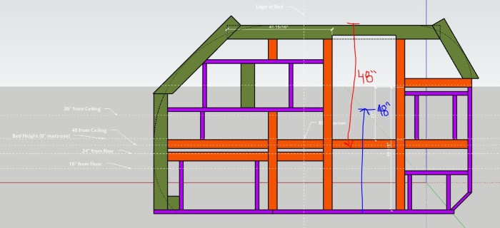

Did i just make a BIG mistake?
I designed and cut the lumber for my wall frame this weekend...
And I think I made a fatal mistake...
My intention is to order aluminum skins from Hemet Valley or Macs Aluminum... (I have quotes from both...)
It seems both use 4' rolls to make the skin, so each side is comprised of two sheets of 4' with a seam in the middle, so I designed my frame with a 2x4 at the 48" mark so I have plenty of room for the seam...
Here is the mistake... i measured 48" from the TOP for the seam...
And now that I am thinking about it... I need 48" from the BOTTOM for the seam? Right?
Did I make an OOPS?
48in top vs bottom.JPG (45.38 KiB) Viewed 867 times
RBB
Posts: 85
Joined: Sat Feb 11, 2023 7:31 pm

Postby RBB » Thu Jul 11, 2024 11:36 am
UPDATE:

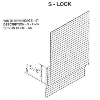

So after sleeping on it for a few days, I finally just went right to the source and I gave Steve a call at Hemet Valley.
Turns out I was kind of right...
SO the standard top half of the aluminum starts as a 48" roll, then the S-Lock is added, which brings the overall width to something like 46".
S-Lock Profile
Screenshot 2024-07-11 112838.png (68.42 KiB) Viewed 831 times

Here is what I didn't appreciate:
The TOP of the TOP piece can be trimmed to meet the needs of the build, as long as the width does not exceed 46".
(This makes sense because you would trim the top edge to match the profile of your build).
The TOP of the BOTTOM piece can ALSO be trimmed to meet the needs of your build, leaving the Auto Mold at the bottom intact!
The CUT edge of the BOTTOM piece then tucks inside the S-lock, hiding any imperfections, and creating the water tight seal. You still want to be as accurate as possible because you only have approx 1/2" overlap.
The ROOF will bent over the TOP EDGE of the TOP piece creating the water tight seal there!
