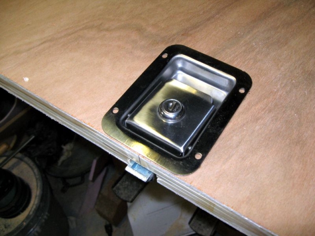

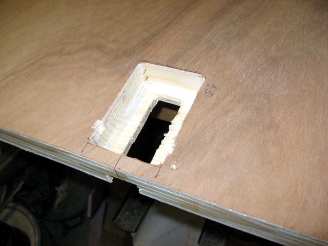

I agree with you on this lock design, it is fiddly and mostly designed for very thin plastic or metal door skin to be installed easily.
In my build It required some trial and error to fit this lock in to my door with 3mm plywood skin too, but it worked in the end.
I just kept working on it and it did fit. Below are the pictures how I did it.
The opening you made is too big.
If I remember correctly, Instead of making a bigger opening I had to cut the bolt opening wider to be close to internal plywood skin to install the lock without such big opening as in your photo.
158721155615155614155619
