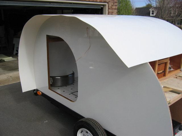

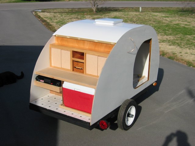

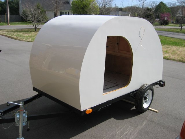

Postby sid » Wed Mar 22, 2006 10:56 am
Spadinator,
The doublestick tape worked great for me. It was 3M part # 950-2. I have used all that I had and still need to do the galley hatch. I have one more piece of polymax ordered from Farmtek for the galley, so I ordered a roll of their industrial strength double faced plastic tape (part # LJ7587) for $5.95 per 25 yard roll. Hope the results are the same because it sure made life easy.
Ron Shaw has used the Henry carpet adhesive with good results also. The advantage with Henry's is you have time to work with it and line things up before it sets up. He has some photos in his gallery.
With the tape, it's instant stick.
