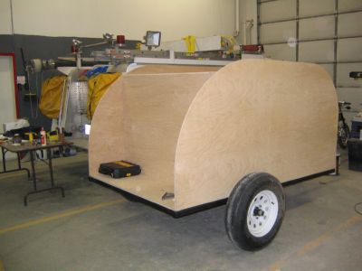

Postby ezbie » Fri Mar 24, 2006 1:07 am

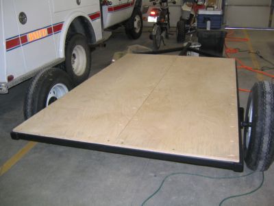

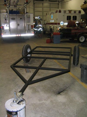

I have posted some pics of my progress in my album. Take a look. I am actually a little further along that the pictures. I have the framing in and I also have the undercarage coated (but no pictures) I did the undercoating with HERCULINER paint on bed linning. Worked great but kinda pricey $100 a gallon only needed one gallon though. I wanted something tough and durable so I figured this was a good place not slack.

It looks great. How thick does that Herculiner go on? Did you use all of it on the frame?

Hi Shane, As Larry said, looking good. I must admit that I do like that profile. :)

The herculiner is about 1/8" thick. The gallon covered the whole underside including the exposed plywood. I still had about a 1/4 gallon left also. after the herculiner was dry I also caulked the seems with black silicone between the plywood and frame just to be sure that no water could get to the plywood and cause damage.

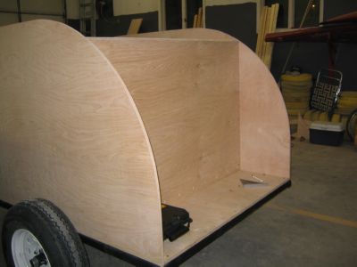

NO DOORS??? Just climb down from the top?? :lol: It would have been alot easier to cut the doors with the sides laying down flat.
Looks Great. Nice frame. :applause:
