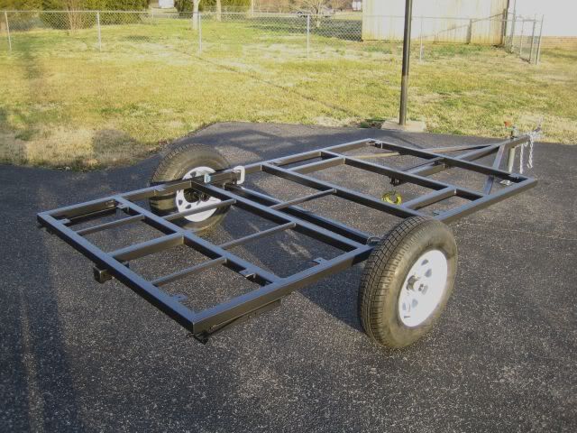

I did the same thing. All you need to do is scuff them up and paint with only the Hammerite paint. The Rustoleum does not need a primer.
This photo is before I painted, I used the Rustoleum Hammerite Green paint.
