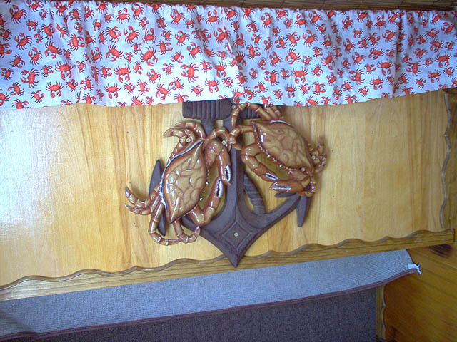

Anyway, I have two extra lengths of the scalloped molding you see here. (Why I have two extra lengths of this while I still need two MORE lengths for my front cabinets is an HILARIOUS story that I'll one day post in Mikenchell Bloopers and Blunders.)
I was thinking that this would look really cool as trim for the top of the fenders, with rope used on the top of the sides. But this trim I have is already STAINED.
It's the standard Miniwax oil-based wood finish, so do you think I can throw it in my pool to soften it for bending without damaging the pool and/or filter? I stained it like a week ago.
