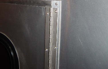

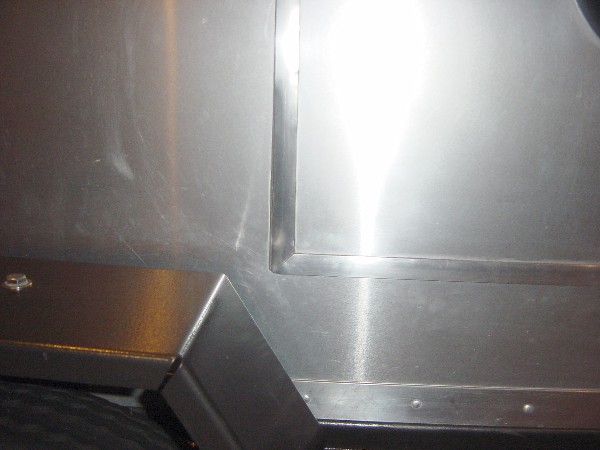

Postby asianflava » Sun Jun 04, 2006 6:22 pm
Ok I got them resized and uploaded. The wall side is 1X1/2x1/8 angle and the door side is 1X1X1/8 T-molding. BTW: I'm using Grant's offset hinges, with an 1/8in offset. The doors and walls are 1in thick

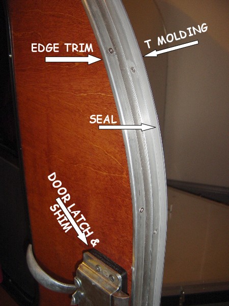

Postby Endo » Sat Jun 10, 2006 9:52 am

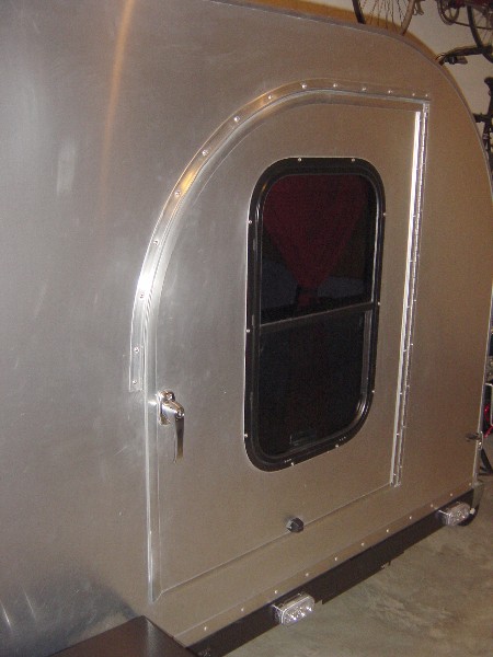

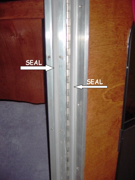

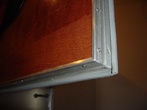

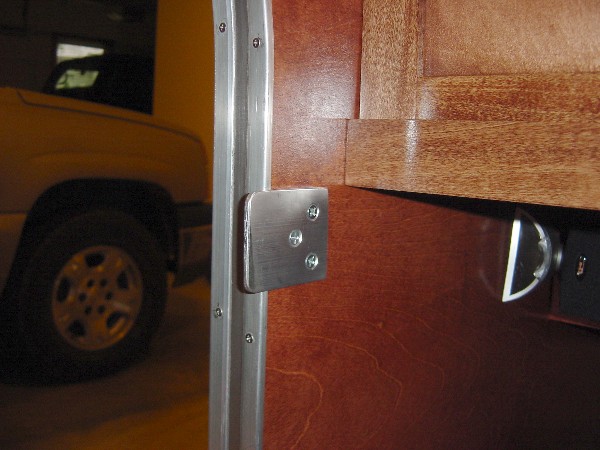

Not sure if you still need photos but here you go. I moved my door handle "inboard" so I didn't have to notch the T-molding. I then made a strike plate for the latch. The hinge side of door has two seals, one one the door and one on the door opening. I formed the rain gutter to follow the profile of the door. The perimeter of the door only has the seal on the T-molding. I am happy to say no leaks yet!
Purchased all of the trim here.
http://www.teardropparts.com/sub-pages/ ... ldings.htm
Very easy to bend/form!!!!

Postby asianflava » Sat Jun 10, 2006 2:09 pm
Hey, how come those corners don't have gaps in them?
Good job on those miters. :thumbsup:
