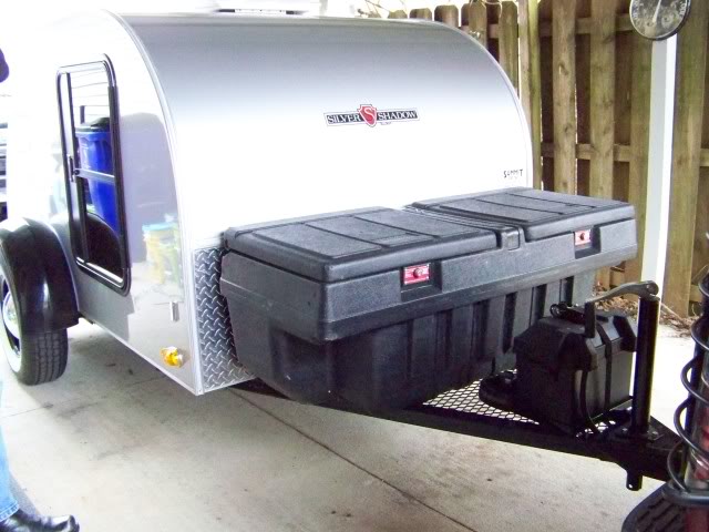

Postby skulli69 » Sun Jan 24, 2010 10:42 am
115V hook up is located on drivers side just behind tire, the small black cap to left side of image
the fuse block should be under the bed, driver side front
the battery should be mounted to the tongue, if you have the power package
we bought ours new and found there is no real owners manual :shock:
as for the fan there is 3 cut off switchs, 1 is the in/out switch, 2 is the speed switch, 3 is the cover switch the cover needs be about 2 inchs up to release this switch.
hope this helps :thumbsup: :thumbdown:

Postby stumphugger » Sun Jan 24, 2010 1:11 pm
Yup. It is the battery I am wondering about. I got the battery, and the pickup is wired to charge the battery, but I'm not seeing anything leading back from the battery to the trailer. I'll look closer. Thanks.

Postby iplay10us2 » Sun Jan 24, 2010 1:37 pm
It should be underneath the frame area near the battery. It is most likely also cable tied to the wiring for the tail lights/turn signals.
