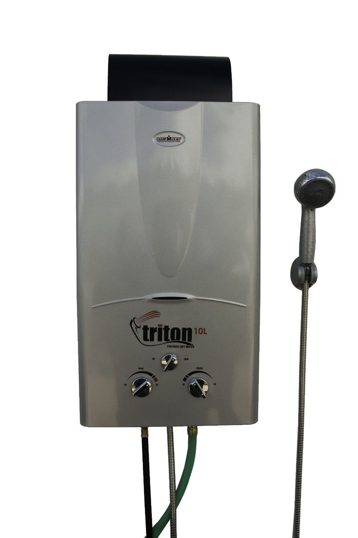

Postby fazeller » Wed Jun 03, 2015 4:20 pm
here's a pic of it 13.5x8.5x31 are the dimensions

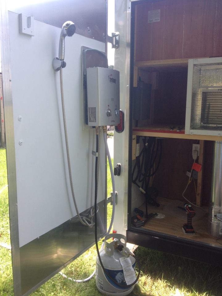

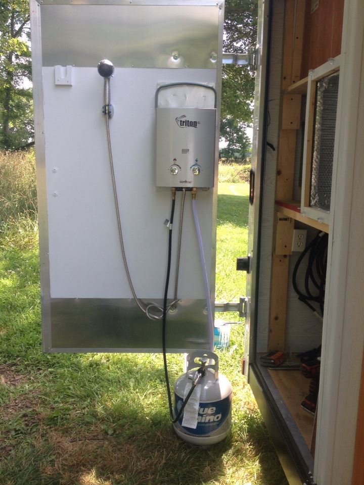

Postby Rainier70 » Wed Jun 03, 2015 7:13 pm
Awhile back I think there was someone in the Cargo Trailer forum that made a mount that fitted on the tongue. They had some water connections in a panel there with some quick connect fittings. For traveling they had a wall mount inside where they could hang it.
I am not sure on the brand they had, but using Google Search you might be able to find a couple of other examples in there too. Sorry, I can't remember better.

Postby Rainier70 » Wed Jun 03, 2015 7:20 pm
Here is one setup in a slideout kitchen unit.

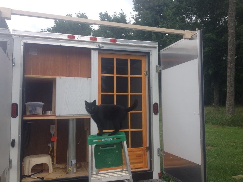

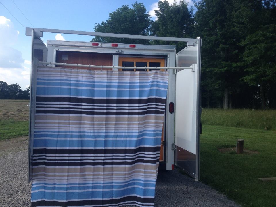

Postby fazeller » Tue Jun 09, 2015 2:36 pm
shower area.jpg (95.42 KiB) Viewed 3791 times
Well we sent the 10L triton back as it was way to large. Have ordered the 5L one that is shown in most of the pics you all added. We have devised a way to use and over the door hangers to attach the heater to that so when we need it we will hang it over the back door. Have made a bar across the top of doors to keep them from moving. Installed another rail to hang up a shower curtain and will hang the water heater over the door will post pics when we get it don

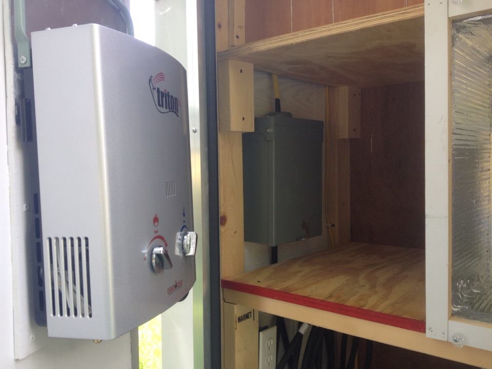

Postby daveesl77 » Tue Jun 09, 2015 6:34 pm
For tent camping, with my 5L, I made an "all in one" aluminum plate holder that attached to a collapsable shelf system. Essentially I had a piece of 1/8" aluminum plate about 20" x 14". To this I mounted the water heater and kitchen sink faucet system on one side and a small 12v pump on the other. I made all water lines the plug in type, so if connected to city water, then that fed the system, if not then I fed from an 8 gallon tank. In addition, I put an on/off switch and replaced the D cell batteries with those fake batteries where I installed a 12v-3.3v converter. This allowed me to just flip a switch to shift from cold water to hot. I then added in a foot switch attached to the pump by way of an 8' cord, made from an old car dimmer switch, that allowed you to turn the pump on and off while in the shower.
With the new setup, it is still a bit similar, same foot switch, same battery replacement system, but the heater now rides in a compartment in the galley then attaches to the back of the cabinets when galley is extended. Pump is now permanently installed in the camper.
Found the photos... (these were taken before I added in the switch for the pump

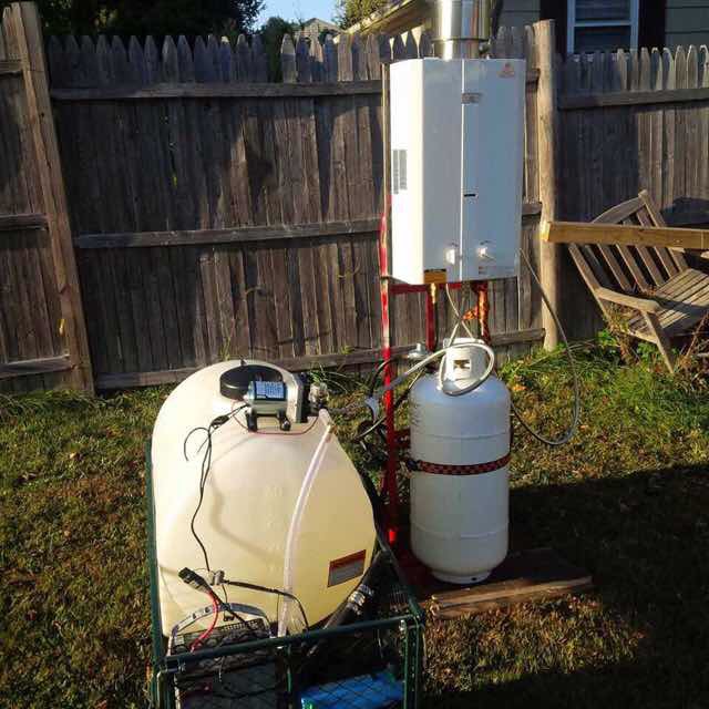

Postby smartdave » Tue Jun 30, 2015 11:19 pm
Here is what I do when dry camping
