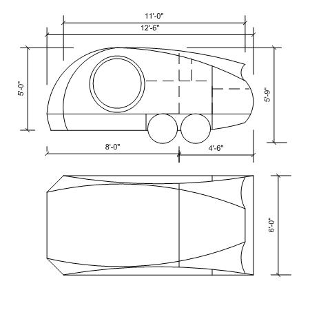

I've been playing with design ideas for a long time but now I've been given the green-light by my wife after our last trip.
The objective is to have a galley that is capable enough for the six of us. We usually are covering a lot of miles and we try to find a park or somewhere the kids can run around at lunch so being able to get to the food easily and is a big reason for my wife's agreement. I am wondering if I am going overboard though. I have a ~6'x2'x2' for a cooler, I was figuring to build something out of r-30 rigid and coated in fiberglass. Then two 3' wings for stove, maybe and oven, storage. In all about 30 ft2 dedicated to galley.
The sleeper configuration is pretty much the norm with a small table and dropped floor that can double as storage when not the bed. The kids can sleep in the tents.
About the insulation though, I am thinking that the real use for the insulation will be in winter when it is not in use help keep condensation down and the inside dry (with the aid of a small heat source). I am planning a structural rigid shell SIPs, or alternatively do a ribs and thin ply shell. Except for the floor every surface has a curve to it so either meathod should yeild a very strong structure. Doing the rib and ply though is probabably easier to build but if I insulate the SIP structure would help keep the weight down, so is it worth it to insulate?
Thanks for any input,
Barry[/quote]

Postby TD Beej » Thu Aug 27, 2009 2:47 pm
Thanks everyone.

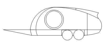

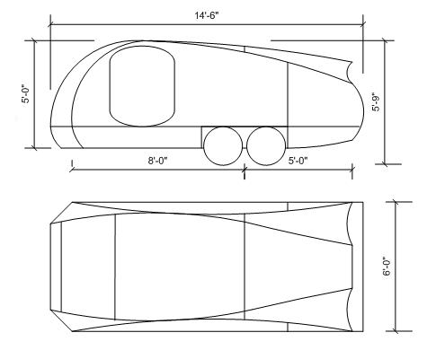

Here are my line drawings of side an top exterior.
Insulation: I am leaning toward only insulating the floor for the mement since it would be easier to add later to everywhere else and we do our trips in the summer.
Construction would be on laminated or bent wood frame with 1/4" luan (or simular) epoxied on all sides and taped at seems. Need to learn to do glass now, steam wood, and make laminated beems.
Frame would be custome build. I need to learn to weld now.
The foot well will leave 30-36" of space between the 6' benches facing each other. (Gotta be able to sit 2 adults and 4 kids). It will still be tight but only be needed in a pinch.
Cooler will be divided to allows a very cold side and less loss when open.
Galley will be very large but allow us a lot of frexibilty for prepairing a quick meal on the go.
The trailer should fit into the slipstream of the caravan and be light weight by using thiner ply but making the shell only curved surfaces (except the floor or where re-inforced by the frame.
Am I missing anything that I should be aware of?
Thanks,
Beej

Postby wlivesey » Sat Aug 29, 2009 11:24 pm
TD Beej wrote:Thanks everyone.
That is one wild looking TTT. I like it! I'd love to see it built but all those curves look awfullly tough.
wlivesey
Posts: 469
Images: 283
Joined: Sun Aug 12, 2007 1:22 pm
Location: DFW, Texas
Postby TD Beej » Sun Aug 30, 2009 10:33 pm
I've been thinking about doing the curves. Really, If I can just get the 4 curved edges right the rest will be easy. I'm still thinking about the easiest way to accomplish them but at least they are doable. A big plus to all the curves is the higher strength to weight, better aerodynamics, and it will just look cool. The aerodynamics are seat of the pants stuff but going by the shape of the caravan, info I've found on tractor trailers, and a box-fish inspired show car I am hoping it will be pretty good.
I also am also making up second, simplified and smaller design (Post Modernaire I). Galley is a little smaller but still large and total storage is about same but not dinette, and about two feet shorter total length.

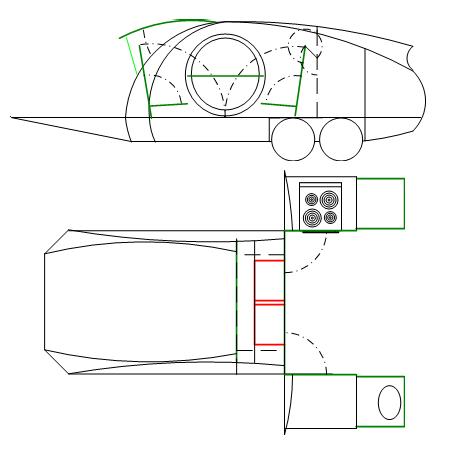

Postby TD Beej » Wed Sep 02, 2009 9:40 pm
Any thoughts anyone. I've Figured out how to get the dinette back. Besides closing in on a final design, I have a think I have a good way to create the main edges.
B^)
