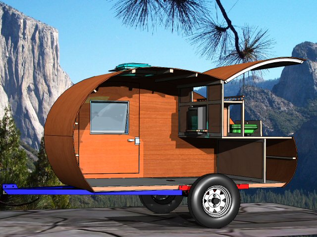

I think we are at the end
Here's what the ultralight looks like...
and if you want to spin it around, here the wrl...
http://www.mikenchell.com/Ultralight/ul ... kinned.wrl
P.S. I am showing the optional 50* tongue in the wrl, which happens to be very similar to what C. Craven sent me this evening...

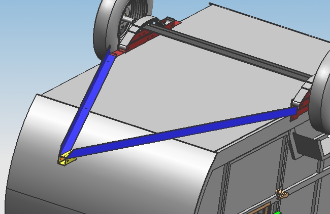

Postby Feral XJ-SC » Tue Feb 28, 2006 1:14 am
angib wrote:I hope Mike will now add a post showing the alternative A-frame tongue that I sent him for the Ultralight, as his 3D lighting skills (or software!) are much better than mine. I believe this could be scaled up to a heavier trailer, using 2" square tube, rather than the 2" angle that is sufficient for the Ultralight. By using an A-frame, the back end of the tongue(s) can now lie right under the sidewall which is as solid a mount as you could want. However on the Ultralight this point is right at the front of the axle mount angles, so the length without a chassis drops to zero.
I kept trying to figure out where the A frame was and I couldn't find it. Why the decision not to use the A frame? Was there a discussion off lthe forum?
Robert
Feral XJ-SC
Posts: 54
Joined: Wed Oct 12, 2005 2:45 pm
Location: Phoenix
Postby mikeschn » Tue Feb 28, 2006 7:47 am
Hey Robert,

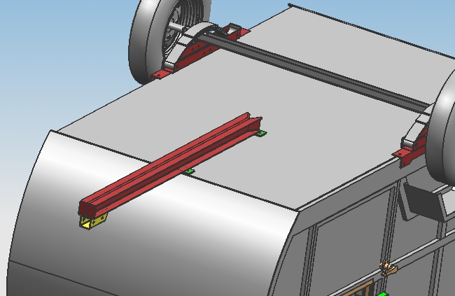

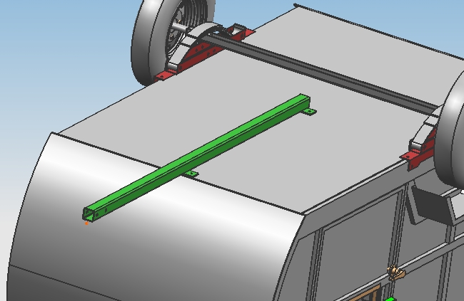

There were three designs that we considered...
All three of these designs would work...
I chose the green tongue with the tabs welded on for it's simplicity.
The blue a frame tongue is nice because it actually touches the angle asm/spring bracket. You could run a bolt thru both, or even weld it up if you wanted. This is the alternative a frame design that Andrew was talking about...
I
But ultimately, I think I will go with this tongue arrangement. This is the alternative straight tongue that Andrew came up with. These are the tongue pieces that came with the HF 1175# trailer. We'll just have them welded together, weld a piece of tube on the top (shown in yellow) for the coupler to bolt to. Strong, light, and affordable! ;) Remember, we have matching plates on the other side of the floor, in the cabin, and the bolts go thru a 2x2 between the top and bottom sheets of floor plywood.

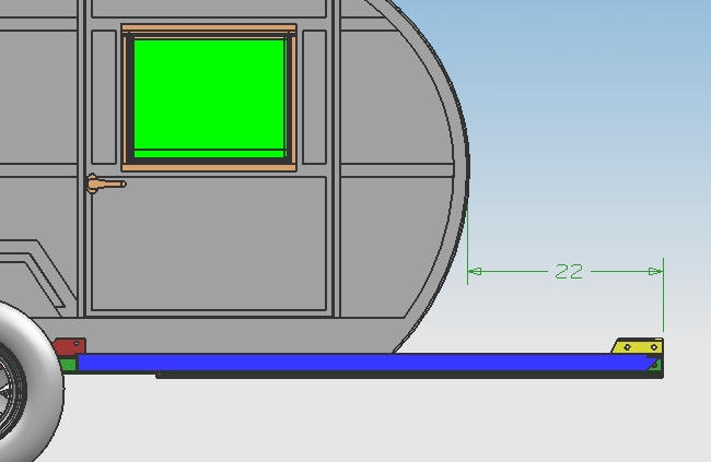

Postby mikeschn » Tue Feb 28, 2006 7:57 am
In each case, the tongue extends beyond the front profile of the teardrop by 22" as shown in this picture...
I believe Andrew worked it out and said the car can angle 45* before touching the trailer. Andrew, did you have a picture of that?
