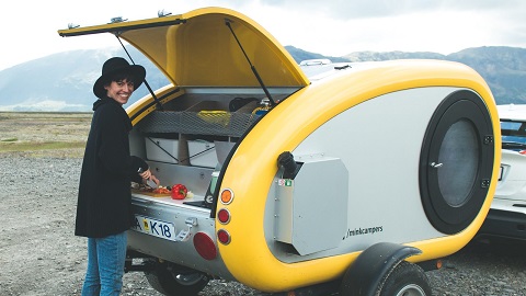

large tear round doors.jpg (50.96 KiB) Viewed 3496 times
Seams it be faster to maker outer rings then infield
Il suffit de le faire
