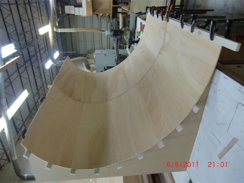

Dry fit panels in form by aligning and clamping the top edge and forcing the curves to lay down. Bear in mind we're using two layers of 1/4" core for flexibility.
Cut the bottom edge so that the panels are in line when in the form - they won't be when they're flat.

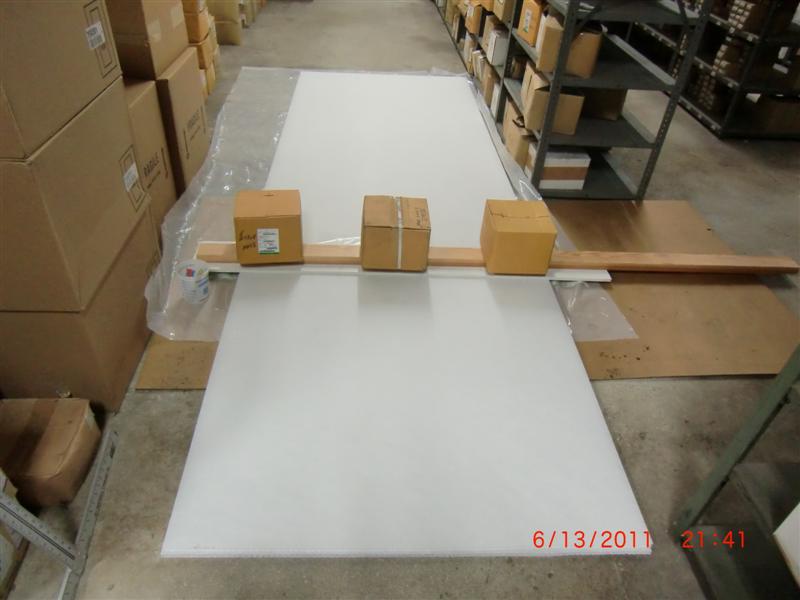

Lay the panels out on top of a cardboard sheet, cut the fiberglass, peel ply, and breather to fit and set them aside.

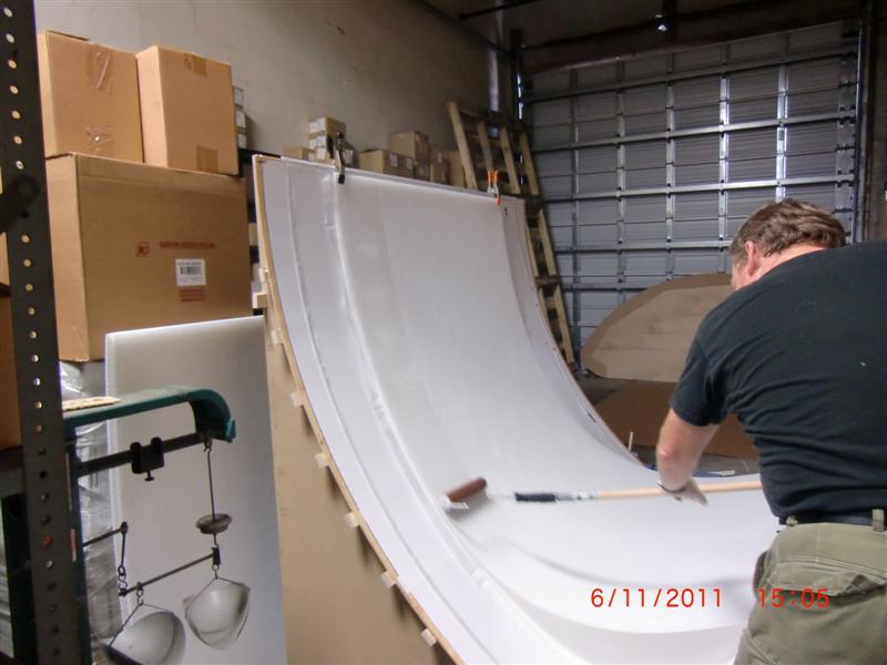

Apply epoxy to bottom (outside)sheet of core.
Lay top (inside) sheet of core onto bottom sheet, align very carefully at the top edge.
Lay fiberglass onto dry top sheet of core.
Roll epoxy to saturate the core veil and the layer of fiberglass.
Lay peel ply onto fiberglass - overlap sides by a couple inches wherever you can.
Lay breather onto peel ply. Don't overlap as much with breather - it wants to be removed along with the peel ply, not separately adhered.

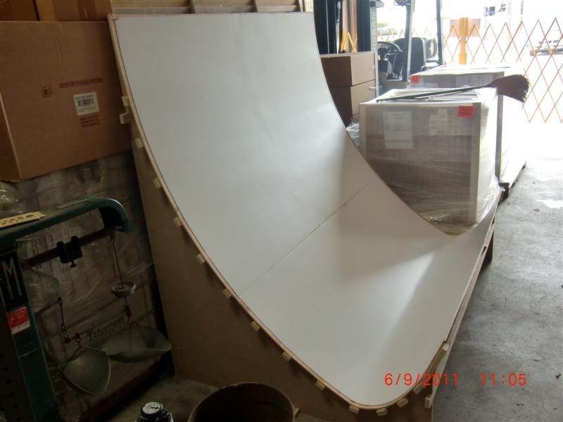

Come back the next morning, pop the vacuuum, remove the bag, and peel off the breather and peel ply.
The core should be stable in the form you've pulled it into, but still a bit flexy - it will stiffen completely when you skin the outside of the trailer.

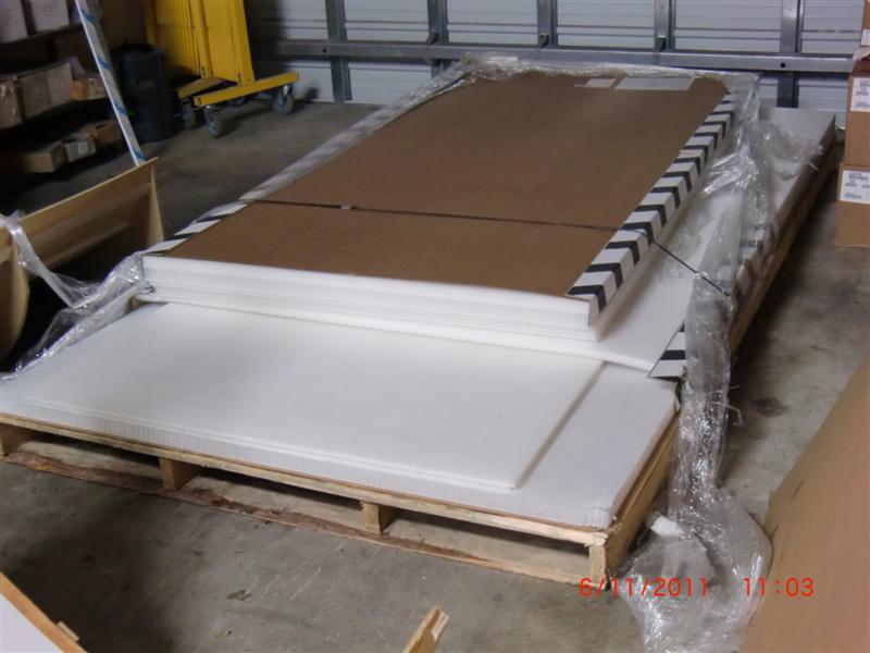

Pallet o' Plascore! Hint: Build four or five if you're doing this - the pallet weighed twice what the core does. Spread the freight cost among friends...

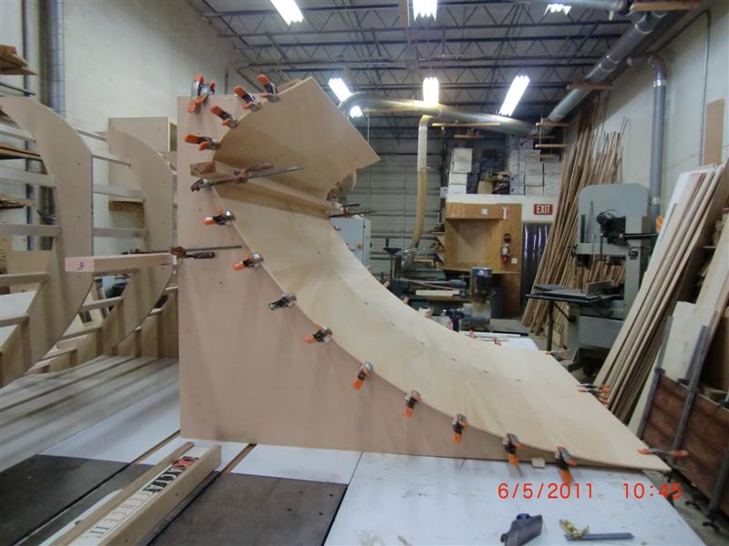

My photogenic side. Please use the method in the text and ignore what the man in the photo is doing - this was the first panel, which we are glad worked as well as it did.

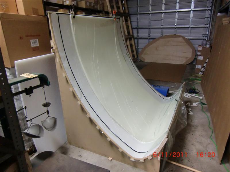

See? It turned out sorta curvy and "back-of-TD" shaped!

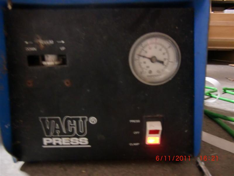

Say "Hello" to my little friend... This is a spendy but VERY versatile vacuum pump, with both regulated and "always on" modes. Down here where it's 85F at night you need a blower running to keep it cool (has a thermal cutout) while it runs overnight for you.

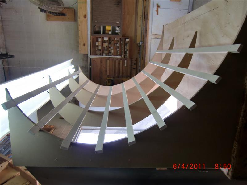

These are the Front and Rear panels for the 5ft. trailer - by this time we were practiced enough to pull down two at once. Note the PVC pipe across the Rear form - it holds the sharp curve into the form during setup and bag placement (and means you only need *one* assistant), and ensures that if you somehow lose vacuum before the epoxy cures you won't have to rebuild the part - the sharp curve will still be there.

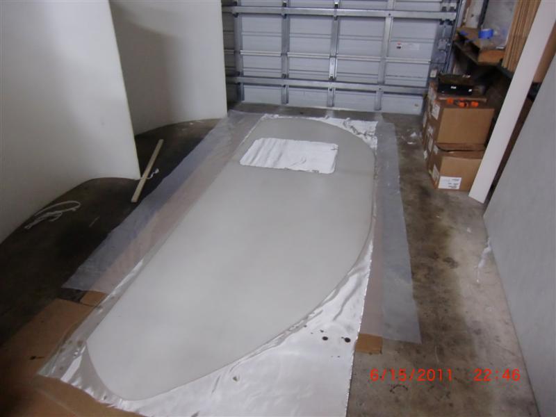

And here's what the 4ft. panels look like when they're out of the mold and freestanding.
