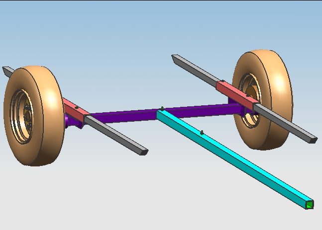

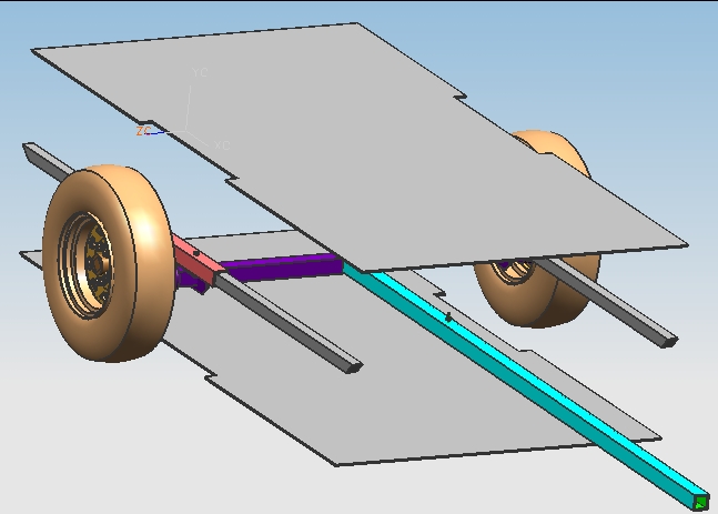

Postby mikeschn » Thu Feb 23, 2006 6:57 am
Thanks for all your input. There are some really good ideas here...
Seeing as how most of us agree that the torsion box is quite strong, I've started thinking about how one could be constructed.
I came up with something that I've never seen before, that should make this rather strong, and durable locally, where the axle is bolted to the torsion box.
Notice the pink colored square tubing that slips onto the side pieces of spruce! That gives you something solid to drill your holes into and bolt your axle to. The top and bottom skins of the torsion box can be notched out to clear the tubing.
The only other steel (besides the axle of course) is the tongue, shown in cyan. It can have a couple pieces of angle bolted to the axle... and a few bolts bolted to the 2x2 spruce running the length of the torsion box (not shown yet.)
P.S. 2x2 spruce is dimensionally 1 1/2" x 1 1/2".
Postby toypusher » Thu Feb 23, 2006 7:09 am
Of course, I'm no 'Andrew', but it looks like a plan to me. :thumbsup: When's the prototype going to be done???? :) How many test miles before putting the teardrop on top??? You can tow it over to my house and back to see how it works :lol:

Postby Loader » Thu Feb 23, 2006 8:00 am
That looks great Mike! Firm mount for the axle and draw bar, but still keeping the light weight goal in sight.

Postby angib » Thu Feb 23, 2006 8:14 am
OK, just to stir things up (it's not only Gage....) I'll say that I don't agree with more than half of what's been said.
Dave, beware of the phrase 'torsion boxes' as the 'torsion' bit doesn't really apply to any of this, except to stop the beams tripping over. What you are describing is many beams sandwiched between two skins and they still just behave, and carry load, like beams. Contrary to what 90% of people think, a 'grid' of beams (ie, at right angles) inside a sandwich structure is an inefficient way of carrying a load - unidirectional beams across the shorter dimension are more efficient (and a lot easier to build).
All this talk of oak makes me think you guys are trying to build a steel frame out of wood. Why? Design it to be made in wood (most probably plywood), using wood's natural strengths rather than working out how to make it look like a steel structure.
But, most of all, everyone stop thinking you're building a house with foundations, a floor and some walls. This is a monocoque trailer we're talking about and the walls are what holds everything else up. The floor is there because without it you would fall out of the trailer when you went to sleep. We need the wheels to hold up the sides of the trailer - holding up the floor is incidental.
If me being this dogmatic makes is sound like I know all the answers, I know that I don't - I'm really not sure whether 1/4" plywood is enough to make the tongue from or if it needs 3/8".....
