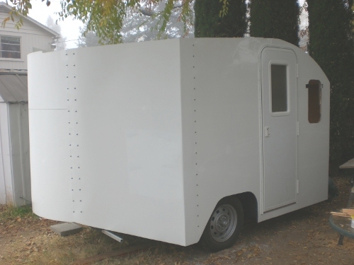

Postby Ageless » Wed Nov 04, 2009 2:21 pm
That 3/4 rear shot is a real optical illusion! With the up angle going to the oundtail . . . .it appears it's a 90 degree corner :lol:
Ageless
Posts: 1603
Location: Pt. Orchard, WA
Postby Prem » Wed Nov 04, 2009 9:06 pm
Optical illusion? Not in person, only in the photos.
It's true to the drawing.
:D
Got all the aluminum flush-cut today (router), and 80% of the edge moulding on with butyl tape under it. Stainless steel screws.
