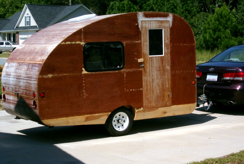

My absense from the forum is mostly a casualty of "Teardrop-time" as well as oppressive Fayetteville summer heat, and now compounded by a move to Tennessee.
So... The Nest'r maiden voyage will a bit ignoble but definitely a 'shakedown' as far as trailerablity issues are concerned. The indignity that befalls her? She will be used in lieu of a U-Haul trailer.
No pretty scenery, no smoke from campfires, no cozy mattress to sleep upon. She's stuffed with gear and bicycles and hitched up for duty; 300 miles to Northeast Tennessee.
In preparation for the journey every bolt was re-tightened, and the wheel bearings re-packed. All the bolt-ons, well, were bolted on. Windows added, door mounted, vent bolted down, and all the lights wired and functioning.
So here she is ready for a hard-day's drive:
Hopefully she'll still look as good upon arrivall!

Postby crumbruiser » Sun Sep 11, 2011 12:41 pm
That is a very nice unit you have there. :eyebrows2: Let us know how the Hyundai does as a TV with the trailer fully loaded.

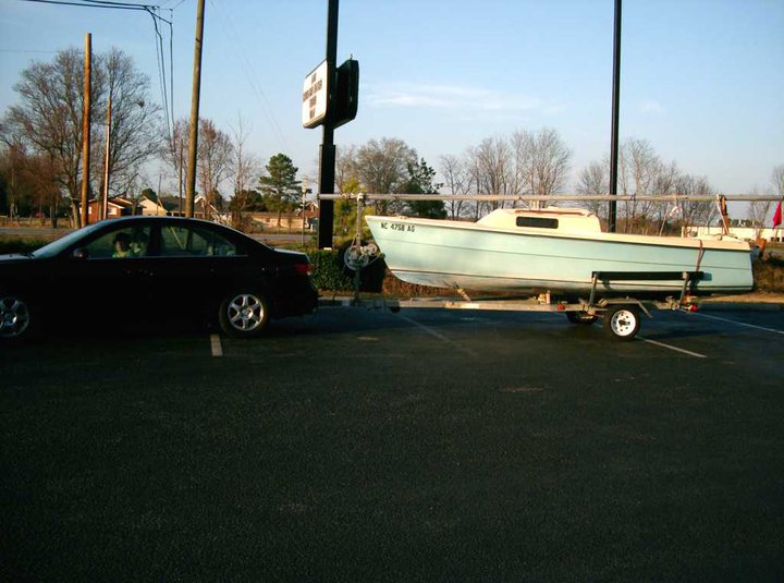

Postby LesterS » Sun Sep 11, 2011 9:07 pm
Well I tried not to get carried away with loading her up. I figured maybe 300 or so pounds of stuff. My guess is gross weight was probably not more than 1200 lbs.
The hyuandai - now with 138,000 miles pulled her just fine. From about 150ft elevation up and over "Fancy Gap" at over 2200ft. The cruise did like 4th gear if the grade got even a little steep. But using the manual mode I could force the car to stay in 5th longer, or make a smoother down shift manually.
The other hit was mileage; from an typical 28 on this trip down to about 16!
The most irritating part of the whole trip though was how much the trailer 'bucked' when the road was less than smooth. Something my sailboat does not do. The boat trailer though, is probably 16ft to th axle and 25ft overall, where the Nest'r is just 9 to the axle and less than 15ft overall. (The HF trailer is fairly 'stubby', exspecially the tongue).
The TV with its other burden:

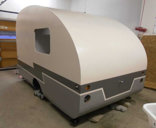

Postby LesterS » Sun Jun 08, 2014 9:58 am
Well, teardrop time seems to have collided with a procrastination event resulting in a time warp/dilation of years instead of weeks! :oops:
Update: The Tow Vehicle (the Hyundai Snot-a) reached 193,000 miles without incident; and well, I wasn't really sure that trend was going to continue indefinitely. Sooo... Tow vehicle replacement time!

The New vehicle is rated at 3500lbs so I do not think towing the Nest'r will be any problem.
Speaking of which... I have resumed work...
121224
And work it is! Let this be a reminder kiddies... DO NOT NEGLECT undercoating the whole sha-bang when you have the chance. Doing it later is a bear. I did use the Fence Post paint "Black Beauty" from Tractor Supply; inexpensive and effective. I have everyone here to thank for their trials, and input in helping to select an appropriate bottom coat.
How's she look right now?
121225
She doesn't look much different -- but she's approaching usefulness at the speed of smell. :o

Postby LesterS » Tue Jul 01, 2014 8:42 pm
We have color.
That is definitely progress. :D

Postby KCStudly » Tue Jul 01, 2014 9:32 pm
That's going to look really nice! :thumbsup:
Re: Progress before post - that's the order.
Postby bonnie » Wed Jul 02, 2014 7:13 am
Love the color combo. :)

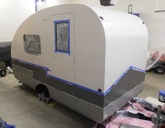

Postby LesterS » Wed Jul 02, 2014 8:47 pm
Second coat of paint and the masking tape comes off...
Now it's time to begin reassembly. 8)

Postby KCStudly » Wed Jul 02, 2014 8:57 pm
The color combination looks really good.
RandyG (IIRC) and I have both been planning some sort of gray tone theme for our builds. I like the way you tied it together with the lighter color for the roof.
