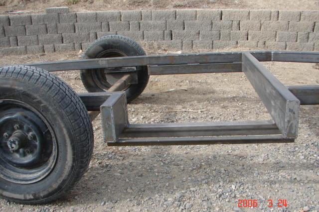

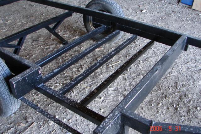

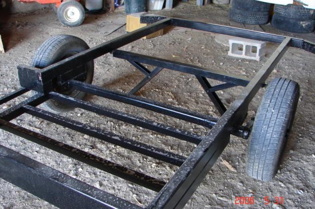

Postby angib » Sun Sep 15, 2013 1:19 pm
Here are some photos of the 'business end' (well, the middle actually) of a Boler fiberglass trailer frame (actually a new frame to replace a rusted one) that was made to achieve exactly what you want. The dropped floor extends through the curbside frame rail to give a level floor inside the trailer. The last photo shows the entrance door point before all the floor supports were added.
This frame design is the key as it gives as little as 8-10" ground clearance near the axle for maximum headroom but then has 12-16" ground clearance at the ends of the trailer where it would ground on dips if any lower.
