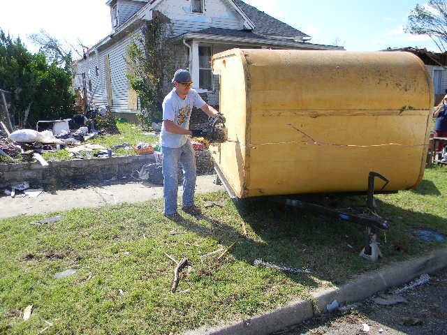

Postby Miriam C. » Mon May 14, 2012 9:11 pm
1/8th inch on top of 1" x 2" spars and it went through the deck. We had to cut it with a chain saw because they couldn't knock it down. The sides are 3/8" Baltic birch, 1x2 frames, 1" foam and 1/8" inside. These things are tough!
Return to Member Designs
