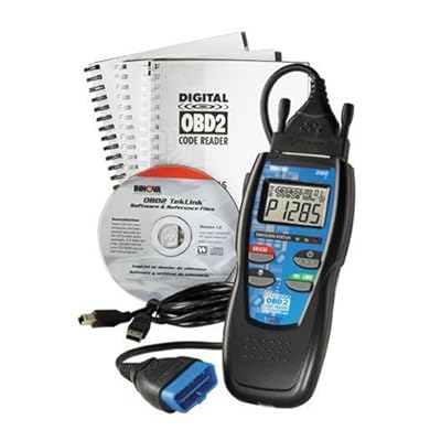

Postby halfdome, Danny » Wed Aug 22, 2007 9:33 pm
Get one of these and do the test yourself, pays for itself the first time you use it :thumbsup: Danny

Postby dhazard » Wed Aug 22, 2007 10:18 pm
Let me guess, you have a Ford product… Check the hose from the EGR valve to the controller. Replace it even if it looks ok, it’s under a dollar. When you are at the parts store pick up a INNOVA 3100 code reader, under $100. Follow the directions on how to clear the code. Dive it a little while and recheck with the reader. That will most likely take care of the problem, if that doesn’t take care of it them do another post.
The INNOVA 3100 is a newer version of what Danny posted.
