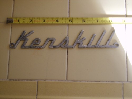

Sadly even if it could be cleaned up more, there is too much corrosion and it will cost a minimum $120 for an okay job.
Does anyone know of a way to have these re-made using the original as a template?
kerryd wrote:Dennis , we have a cnc plasma . It would cost you about $20 to cut out . Plus shipping . About $7 . We can cut it out of Aluminum or stainless . Kerry
angib wrote:Dennis, the CNC-cut from stainless sounds like a really good solution - and you get to spend many happy hours polishing the cut edge to perfection. Don't forget the easy way to make the CNC model - put your existing nameplate on a scanner and then draw over the scan. If you want help with that, PM me.
