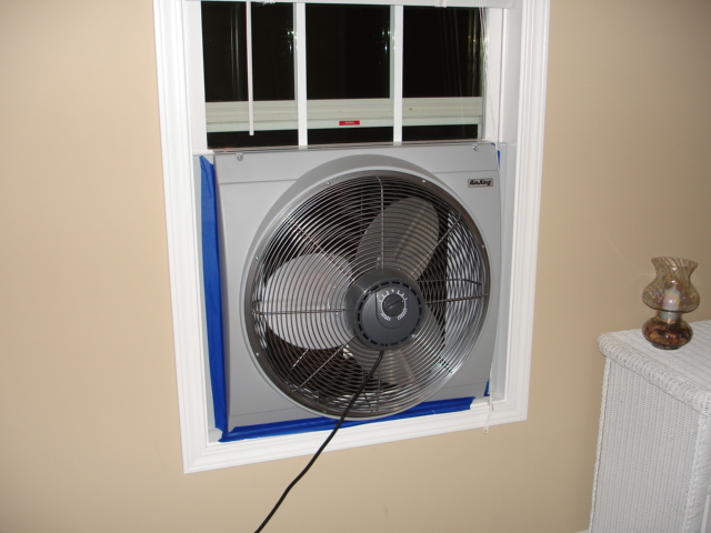

When I was a boy my Dad always installed a whole house fan whenever we moved. You know, the kind that mounts in the ceiling or some that window mount.
I remember having to pull up a blanket in the middle of summer with the windows cracked and the fan running. I have since followed that same practice -- mounting a whole house fan.
There are some drawbacks.
1. don't forget to turn the fan off when you cut the grass!!! DUST in the house.
2. POLLEN. During the pollen season they are virtually useless
However,
Here is a solution I came up with after 61 years of suffering. DOH!!
DA FAN

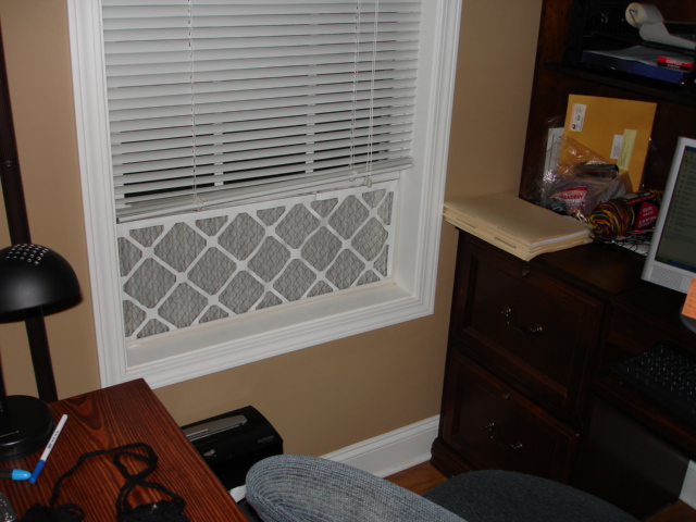

DA Solution:
Found these 12 x 30 5 micron filters that just fit in our windows. Even if you could not find the right size, in 15 minutes you could build a frame and cut a filter to fit.
Works great for us. Wife even thinks they are "somewhat" attractive :bowdown:

Wouldn't take a 5 micron filter to filter out the gnats. The noise might be something else.
