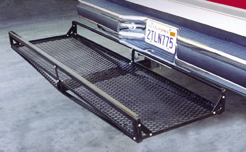

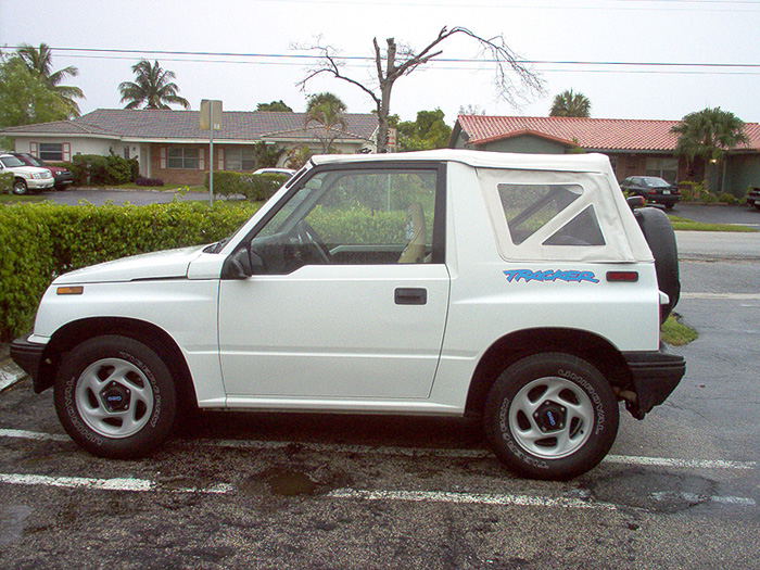

I just ordered the hitch for my Tracker, and I want to add this:
To this:
I gotta make this vehicle more manly. Otherwise, I'm gonna have to paint it pink and give it to my wife. (This car does make me look taller, though.)
The cargo carrier is 20" by 60", either including the edge lips or not--because as you know, HF doesn't go into much detail when it comes to specs. (Especially when those specs are coming from China.)
What I want to do is permanently or semi-permanently assemble an ass box to it. (Since it's at the rear of the vehicle, I won't call it a tongue.) The Tracker has zero trunk/storage space, so I figured this would be nice to have.
So I just got the idea of using a cooler for this purpose, with some kind of a jerry-rigged lock, because this would give me the option of also USING it as a cooler. (The carrier has a 500lb. capacity, which is plenty.)
But can you guys think of any other sources for suitable boxes for this? Forget diamond plate--too much gelt. Also, I want to be able to easily install and remove the entire assembly from the hitch.

The only consideration is which carrier to get, because with that lip on the carrier, the box may go too close to the car door to open. (And yeah, I know I won't be able to open the rear door.)

I was bored and put on my rack and put the box on it and it was fine. My rack is different than the one you are talking about getting, but I would think the carrier you are looking at would be alright...the start of the basket will be more than 2-3" away from the back of your Tracker.

Something you might want to consider....the rack may have a 500# capacity but I doubt your little car has a tongue weight capacity of 500# and that's what anything on that should be considered. Also the fact that you are loading waaay behind the axle doesn't help either...the more you've got back there the lighter your front end will be.
Oh, and don't hide your tailights or license plate either. 8)
Use caution glasshoppa. :R
PS if ya want it manly paint it flat black with spray bombs then take it out in the swamp and rub the sides of it up against some trees a few times. Then maybe it'll look tough, well, maybe not but it would be fun anyway. :lol: :lol:

Postby angib » Mon Aug 27, 2007 6:01 pm
Yup, adding lots of extra weight back there is an excellent way of making your Tracker really unstable......
In this country, Suzuki rate the Samurai (=Tracker) as capable of carrying a 50kg hitch weight - that's 110 pounds.

Yeah, but he could pull some cool wheelies! :lol:
BTW, Ira, I have one of those cargo thingies. It is proped against my dad's garage in Houston, if you want it. ;)
And, first step to manliness is to remove the ghey-looking blue "Tracker" sticker on the side. That would be a huge improvement in masculinity.
Get the tires fliped blackwall side out, too. Cheap way to improve manliness.
A winch on the front would add some testoterone to the Tracker, don't you think?
