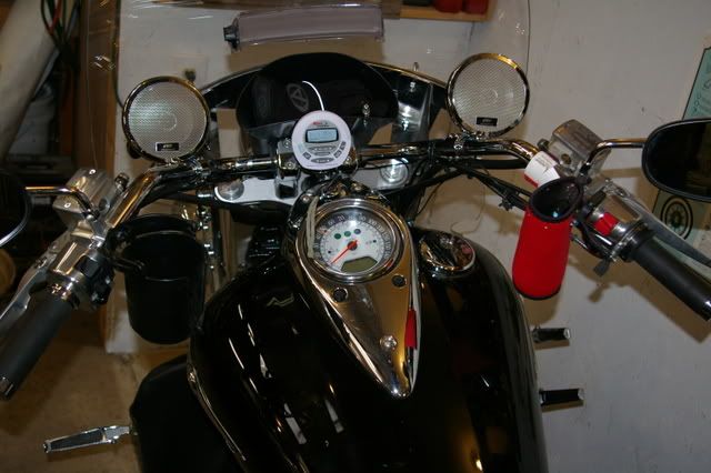

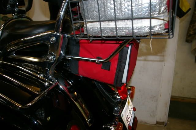

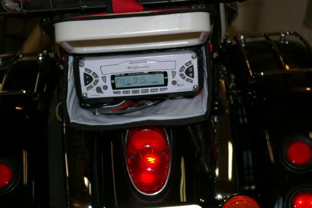

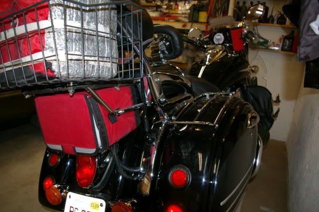

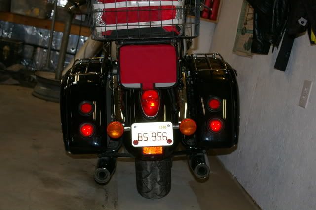

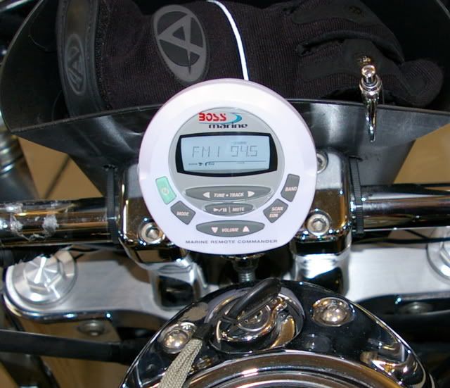

I'm happy to say that after quite a few hours spent, it is finished!
I chose a marine radio with a wired remote, as I didn't want to spend the money for, or have an enclosure in the windshield area.
I considered putting the head unit in the side bag, but it wouldn't fit.
I ended up buying a marine watertight enclosure, and mounting it under the luggage rack.
It looked okay, but the radio was too large to allow the waterproof door to close. No problem, the radio face was waterproof anyway!
However, it wasn't the greatest look... so after a bit of thinking, a ten dollar Wal mart cooler did the trick!
I still have all my side box and luggage area room, the head unit is safely tucked away, and I have the controls at my fingertips.
It sounds good, and I think, looks pretty good.
The big speakers will take some getting used to...but everything comes at a price...
Maybe I'll paint the remote black too...
I did have to modify the license plate location, and the luggage rack, but it was worth it to save the space.
