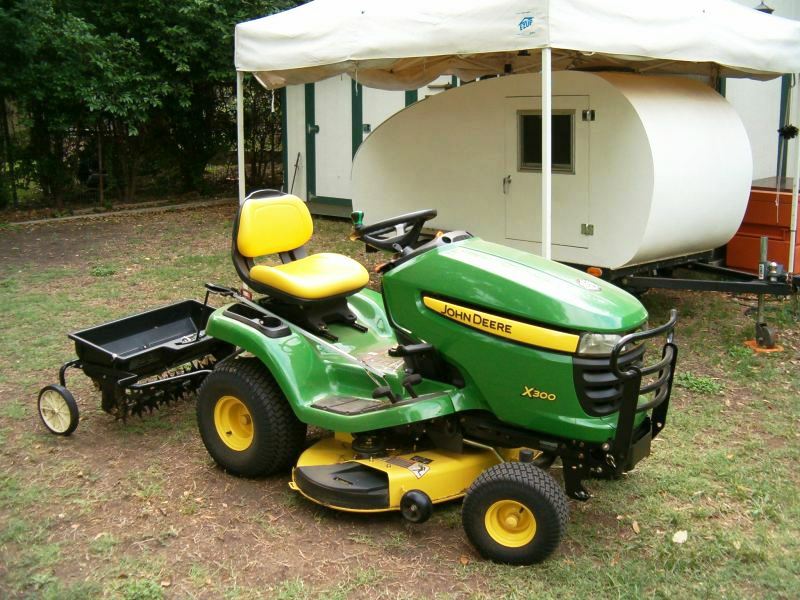

I like this one, best I ever had, it will even tow the TD...... :lol:
