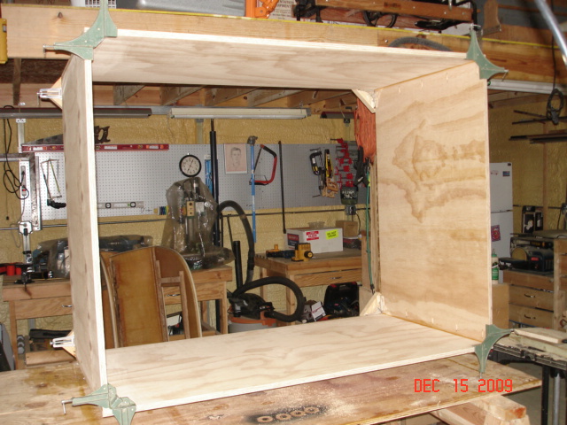

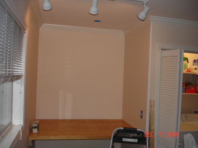

I'm attempting to build wall mounted vertical pull out pantry shelving
Here's the wall:
Here's the Cabinet Frame (will put a 1/4 inch back on it): The Cabinet is 28" deep
The crown moulding will be cut out and the frame screwed to the ceiling joists and back wall studs.
The Idea here is to utilize the space (via step stool) all the way to the ceiling. Therefore pull out pantry shelving (prolly about 6 pullouts)
Here's the Idea: Only they won't be floor length. Just Wall Pantry above the counter top.
The only thing I've found that will work is 28" full extension drawer slides (100 lb rating which is adequate) which I plan to mount on the top of the pull out rather than the bottom (more stable hanging than riding).

That's what I'll have to do only I'll have to top mount mine because I don't plan to have dividers between the pull outs to middle mount the drawer slide on. Also, I'll have "wasted" space at the top where I have to come down below the Crown Moulding. That space can be used for the slides/mounts - If I'm figurin' right :thinking:
