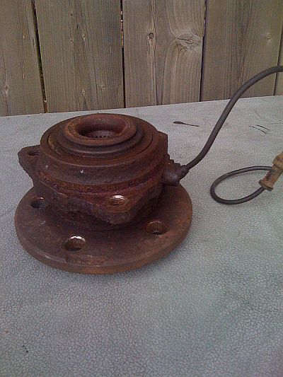

Did you have the key on when you unplugged the ABS sensor? If so, there may be a trouble code set in the ECM. You'll need to find a shop to plug a diagnostic scanner to the vehicle and see what's going on. Probably nothing serious, I just can't see what a bearing would do to make the light come on.

Postby 05liberty » Sun Oct 10, 2010 7:31 am
WarPony .. no I didnt have the key on , didnt unbolt the battey either .
Here is a photo of the assembly , you can see the ABS lead coming out of the sealed assembly
I was hoping to not have to go to a mechanic to solve the issue !

I AM a mechanic AND I own a Liberty CRD. A common problem for the Libby is any item that changes the geometry MAY cause a fault. Have an alignment check done at your earliest convenience.
