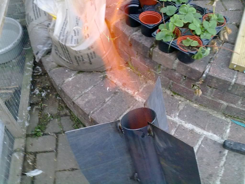

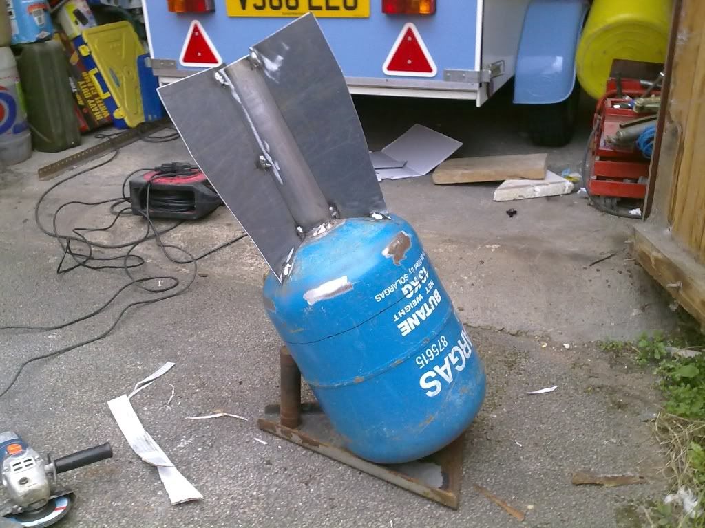

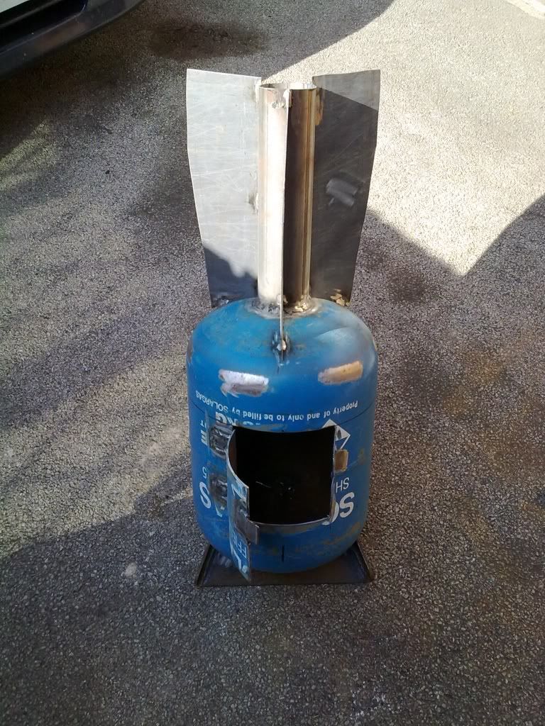

Over here in the UK campsites don`t let you have open camp fires. The solution? a closed campfire made from old calor gas bottles. I am currently building number 3( that looks like an old ww2 uxb sticking out of the ground) but here are the first 2...

with the clean flame burn you have coming out of the third one have you ever thought of putting a circular pipe on the flue to rob some more of the heat? sort of like the Russian fireplace concept.

Your stoves are pretty cool. The top blue one lookd like you could make coffee on top and the bottom one with the fins looks like it would radiate heat well. Very nice.

The "bomb" was just a bit of fun, the base is designed to be buried in the ground so it looks like it has just fallen, especially with the smoke/flame out of the flue!
The valves are easy to remove, just burn as much gas out as possible using a stove. The using a BRASS drift (no sparks) and hammer unscrew the valve. i then stand it upside down for a few days as gas is heavier than air. i then fill it with water and leave for a few hours then turn it over to drain out.
Although the gas is gone the smell is still there. Then simply draw on what you want and cut it out.

The bomb is now finished and doing rather well on ebay.
The next camping one has been started as well as a commision to make one that looks like a banjo
