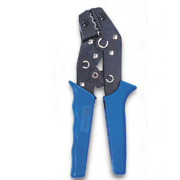

Crimp is the only way.... DO NOT GET one of those $4.99 ones at local auto parts or hardware store.... Spend $30-50 and get quality unit that has interchangeable dies and will crimp insulated and un-insulated connectors of all popular sizes...
These are pretty much junk.. They are cause for crimp connections having such a bad name...
These are what you want.... Ratcheting type with changeable dies...
Good application of dielectric grease to wire before inserting it into connector and crimping will make a more reliable connection and less suitable to corrosion ( keeps the oxygen out) ...
And as mentioned above the quality of the connector makes big difference in its reliability...

As dale says please :worship: do not use this style of crimp tool. They are reliant on the operators grip strength to make the crimp and as we all know this varies from person to person but also how long you have been using the tool that day. Operator fatigue plays a big part in the quality of the crimp.
With the ratchet style the quality of the crimp is repeatable as when you start to close the handles the ratchet engages and wont release until the crimp is fully made and it is the same every time.
I work for a manufacturer of industrial connection products and one of the issures we regularly get on the technical desk is failing crimps. My first question is "what tool are you using" the second is "when was it last checked?" and third question is "what crimps are you using?" These three factors have a major impact on the quality of the connection.
