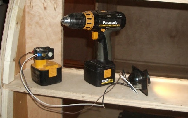

Postby pohukai » Sun Jun 14, 2015 11:58 am
I use 12v drill batteries (3amp/hr). I could connect 4 in series for a big weekend, but 1 has been more than sufficient for the interior/porch lights and the computer fans for ventilation.
For my camping purposes, this has worked out excellent.
I can also connect a shore line to an old computer power supply and use the 12V rails for unlimited 12v power. I've NEVER used this when camping.

Postby GuitarPhotog » Mon Jun 15, 2015 12:02 am
pohukai wrote:I use 12v drill batteries (3amp/hr). I could connect 4 in series for a big weekend, but 1 has been more than sufficient for the interior/porch lights and the computer fans for ventilation.
No, you need to connect them in parallel. Connecting four 12 V batteries in series will produce 48 V, enough to burn out lots of things. Four 3 AH batteries in parallel is equal to one 12 AH battery.
Don't use a computer power supply to charge a battery, the voltage is too low and you will ruin your battery quickly.

Postby pohukai » Mon Jun 15, 2015 9:05 am
Thanks... You're right and I do connect them in parallel. I completely disconnect the batteries if I'm using the power supply and do not charge the batteries with it.
