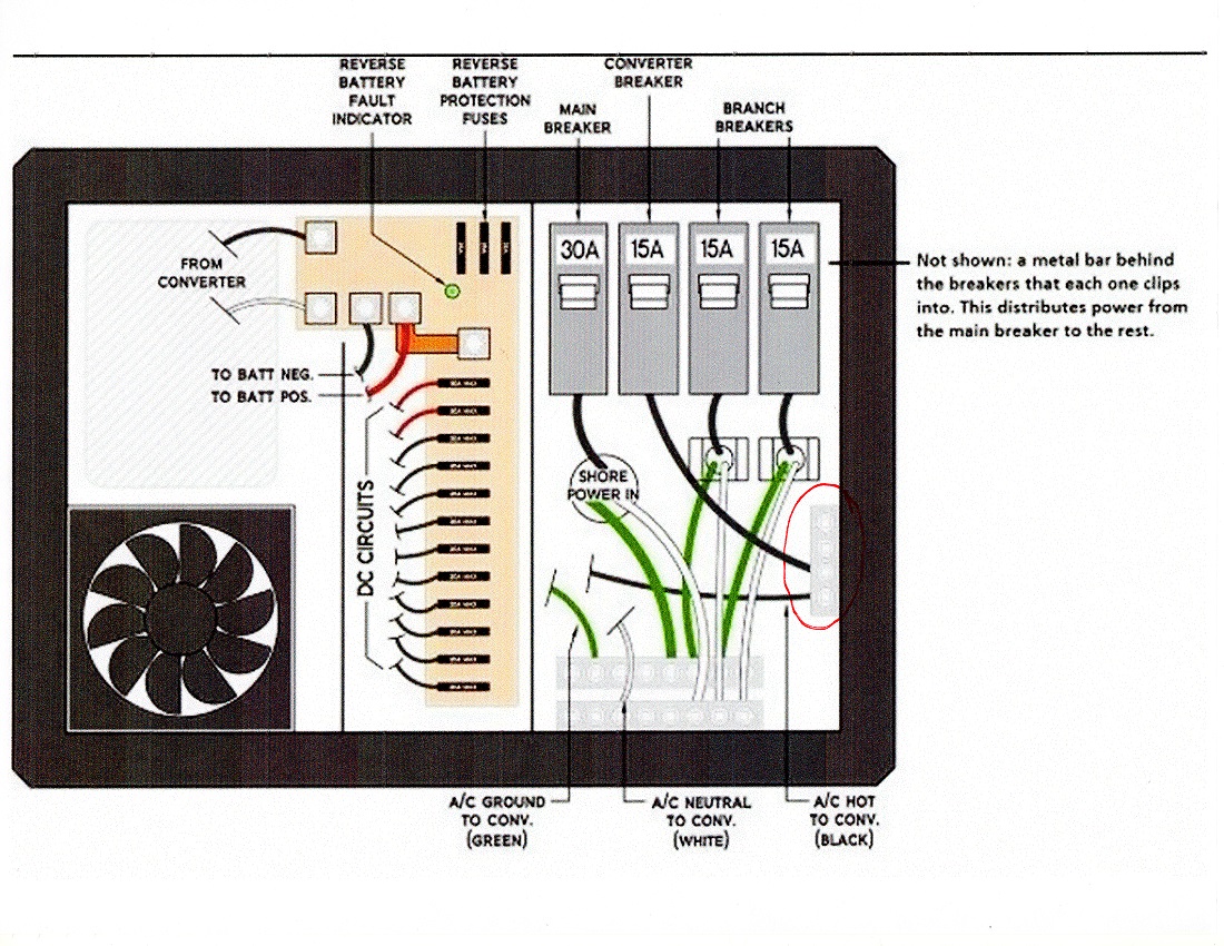

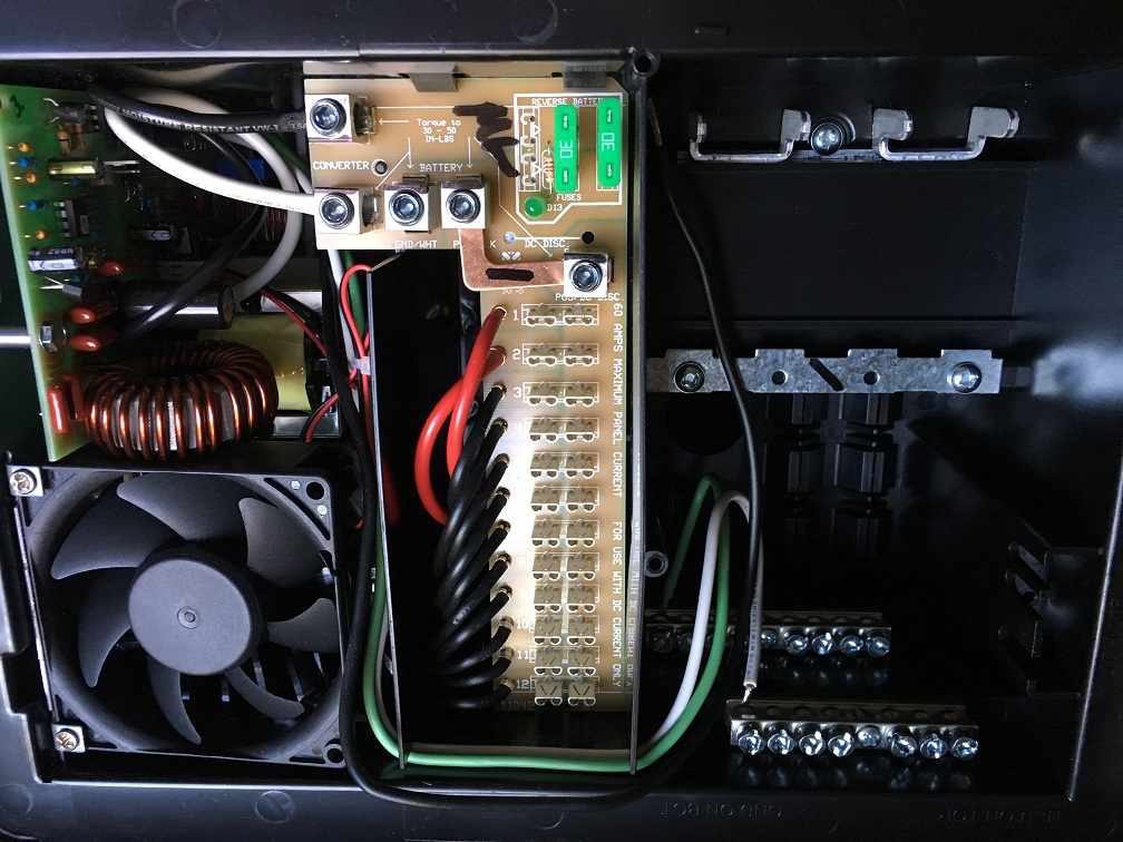

Why install the black pos. from the inverter to the non-supplied bus bar? As shown in the colored diagram. Why not directly to the 15 amp. breaker? (Red circle shows the non-supplied bus bar.) Is the bus bar needed for other necessary applications? I will also supply a photo of my actual new product still in the box showing there is no bus bar installed. Thank you for clarification; I don't want to do this incorrectly. MEL

That's interesting that they no longer supply a hot bus bar. At the time I made the wiring diagram, the black, white, and green wires to the converter were already terminated at their respective bus bars, so I just made a short jumper wire from that hot bus bar to the breaker.
Since it appears Progressive Dynamics is cutting back and trying to save $0.31 cents per unit and no longer supplying the hot buss bar, your black wire from your converter will go directly to the breaker, as you described. This will be good information if other people discover the same scenario.
