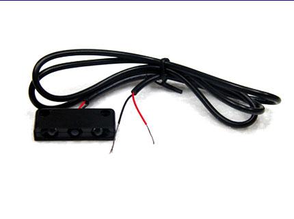

Heikki - I have a similar license plate holder/light (not quite as pretty as yours). It too had a regular incandescent bulb, & besides that it was designed to use the chassis as a ground & I didn't want that with my setup. I stripped out the bulb socket & wire, & ordered a small 3-LED light from a vendor on eBay, then I simply glued it in place of the original bulb/socket using 5-min epoxy. You have to be careful to properly align it so the LED's shine downward toward the license but that is no big deal. Even tho I used 5-min epoxy, I let it 'cure' overnight (held the light in place with rubber bands 'til the epoxy set-up, doesn't matter if the rubber bands stick to the epoxy as you can merely trim 'em off). Then I just wired the light into my tail light system as normal. Works great & provides as much light as needed without being too bright. Here's pic of one similar to what I used (I ordered white but they have every color of the rainbow), along with a link to one eBay vendor (there are dozens of vendors that'll ship anywhere in the world) -

Nobody wrote:Heikki - I have a similar license plate holder/light (not quite as pretty as yours). It too had a regular incandescent bulb, & besides that it was designed to use the chassis as a ground & I didn't want that with my setup. I stripped out the bulb socket & wire, & ordered a small 3-LED light from a vendor on eBay, then I simply glued it in place of the original bulb/socket using 5-min epoxy. You have to be careful to properly align it so the LED's shine downward toward the license but that is no big deal. Even tho I used 5-min epoxy, I let it 'cure' overnight (held the light in place with rubber bands 'til the epoxy set-up, doesn't matter if the rubber bands stick to the epoxy as you can merely trim 'em off). Then I just wired the light into my tail light system as normal. Works great & provides as much light as needed without being too bright. Here's pic of one similar to what I used (I ordered white but they have every color of the rainbow), along with a link to one eBay vendor (there are dozens of vendors that'll ship anywhere in the world) -

After looking in my own lil accessories box I found my original Led light somthing like you mention or show.. but ok the case of crs came upon me during the excitement of receiving this light and license holder today but I have a clear one that is much like the one you show .. I,ll see if I can do the same thing as you did..
Maybe it will work as good.. but I just dont care to have a bulb in this when all else is Led all around.. such as yourself..

Okay Harvey and others
Here is the light I happen to have here at home that is similar to what is shown above..
I,ll give it a try to adapt that to the inside of the new plate holder and light. Whew such a coincidence.. :lol: :lol:

Postby Nobody » Fri Oct 05, 2007 7:03 am
Primary reason I went the way I did was because my license plate holder & light was designed to use the chassis as ground (only 1 wire) & I didn't want that since mine is mounted on the hatch. I couldn't figure out any easy way to add a ground wire & simultaneously insulate the steel of the holder from the aluminum skin so I just stripped out the entire bulb socket/wire & replaced with the 2-wire LED. Simple solution to a probably simple (but vexing for me) problem ;)

Well I did happen to find my Led Light that I mentioned in previous pics on this thread.. I change the light bulb to the Led.. and I got somthing of a pic for you...
Its no more a 10 watt bulb but but a 2 wire 12 volt Led...
