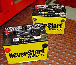

On a similar note, I hope you didn't buy a Wal-Mart "EverStart" brand battery. They seem to have longevity issues. In fact, 4 out of 5 batteries I replace at my shop are EverStarts. So, around the shop, we call them "NeverStart" batteries.
