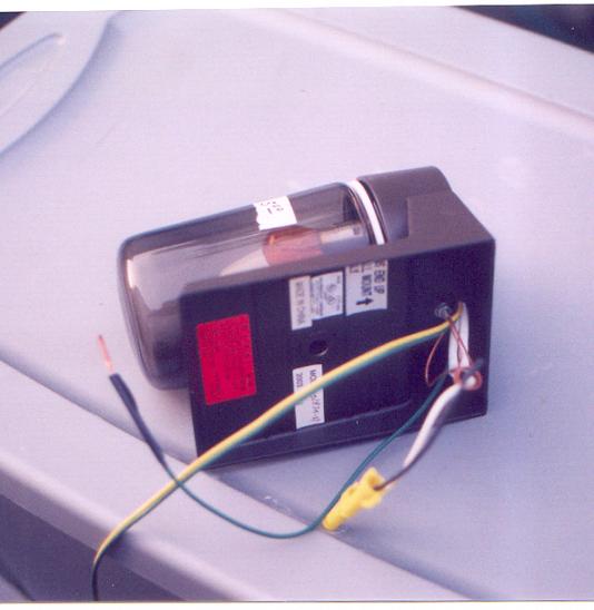

I wired for both and altered the lighting fixtures by adding a 12 volt bulb and the necessary extra 2 wires to run it. Both porch lights and both (his and hers) inside fixtures.
The yellow and green wires were added for 12 volt !

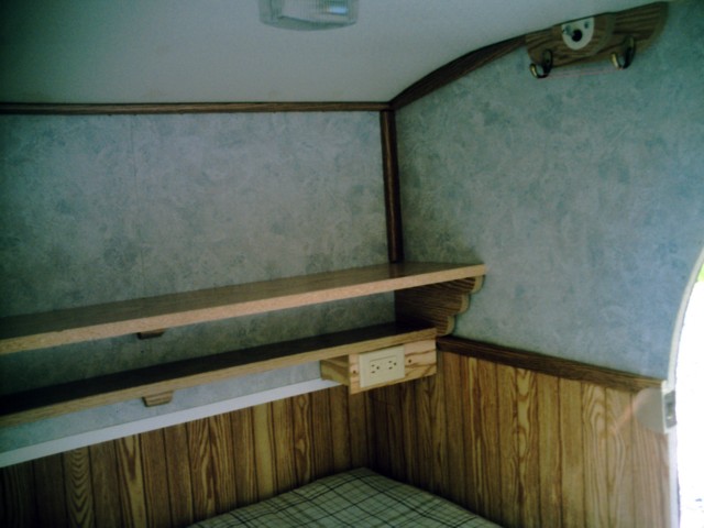

It has been really handy for me to have both 110v and 12v on the TD. On mine I kept both circuits separate...the only place they meet is through the battery tender.
I use 12v for interior lights, reading lights, galley light, porch lights and a couple of 12v power outlets.
I rarely use the 110v side except to occasionally charge the battery.
On mine the 110v wiring is very minimal...I bought a power inlet assembly from a local RV store, it is mounted through the TD body right behind the box that mounts the rear interior 110v outlet in this photo:
From there a short section of Nomex wire runs through the rear body to the galley and up to the top shelf where it powers the 110v outlet for the galley. That section of 110v is also connected to a switch that runs 110v to the battery tender that is mounted next to it. The 12v output from the batter tender runs over to the fuse box that is on the right side of that shelf in this photo:
It's simple, easy to do...but works very well. I don't use a lot of power, last season I barely ever charged the battery and only plugged in to 110v to run a small heater when the temps dipped.
The only thing I plan to change this year is to add an invertor so I can charge phones/computer/MP3 players when I don't have 110v access.
