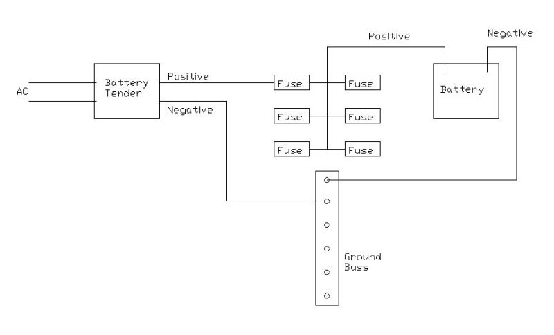

Postby Larwyn » Fri Sep 05, 2008 8:41 am
Okay, I'll try to speak more clearly this morning............... :lol: :lol:
The Battery Tender comes with a fused positive lead which is inteded to be connected directly to the positive battery terminal. In order to keep my wires somewhat under control I needed to cut this long wire anyway and doing so would eliminate the factory fuse, which would need to be substituted or relocated.
If you are using a fuse block, it will have a "positive buss" to supply all the fuses with a connection to the battery positive. So if you connect the Battery Tender positive lead to one of the fuse positions (instal a fuse of the same rating as the factory fuse which was cut off the lead) your connedction will be electrically the same as if you had connected that fused lead to the battery. Actually in my case there is the thermal circuit breaker in the positive lead between the fuse block and the battery, but that will be fine.
The negative/ground, in my case was connected to the ground buss where all the other grounds land. Anywhere which is connected directly to the battery negative terminal is fine.

Postby rhltechie » Fri Sep 05, 2008 9:02 am
Thank you for your drawing larwyn. This was the way I understood it from the first post..but the drawing clears it all up very well.

Postby Larwyn » Fri Sep 05, 2008 9:09 am
rhltechie wrote:Thank you for your drawing larwyn. This was the way I understood it from the first post..but the drawing clears it all up very well.
Thanks!!
No problem. The drawing was easy, remembering how to export it as a BMP then convert to JPG was the tough part............... :lol: :lol:
Glad it helped.
