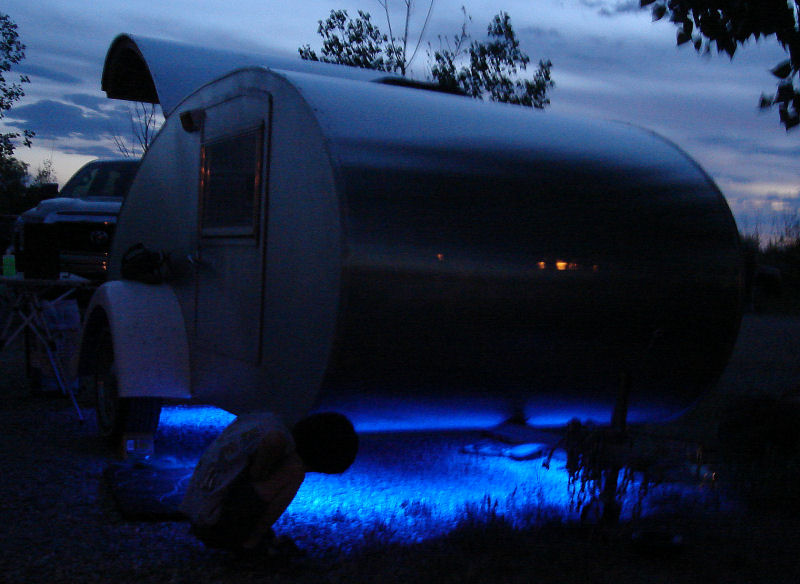

Yeah, that's one of the reasons why I did it. Makes it easier to find your way back to the campsite in the dark. The other reason is because the tear looks like a spaceship, what spaceship doesn't float.
It is an undercar LED kit for those ricer cars, ala Fast and Furious. BTW: that movie ruined the import scene and not all imports are ricers. If you go on eBay you can find tons of them on there in all kinds of colors, a kit runs about $50. Be careful to check the shipping if you buy from eBay, some had really low prices like $10 but shipping cost $50.
The kit has weatherproof tubes that house the LEDs. You just clamp the tubes underneath. They all connect to a control box that connects to power. This control box also allows you to make them flash and chase, I just leave it on. The old kits used neon tubes, kinda fragile and will probably drain your battery.

You're not the only one who was wondering. (stole this pic from Jeanette "jmtk")
